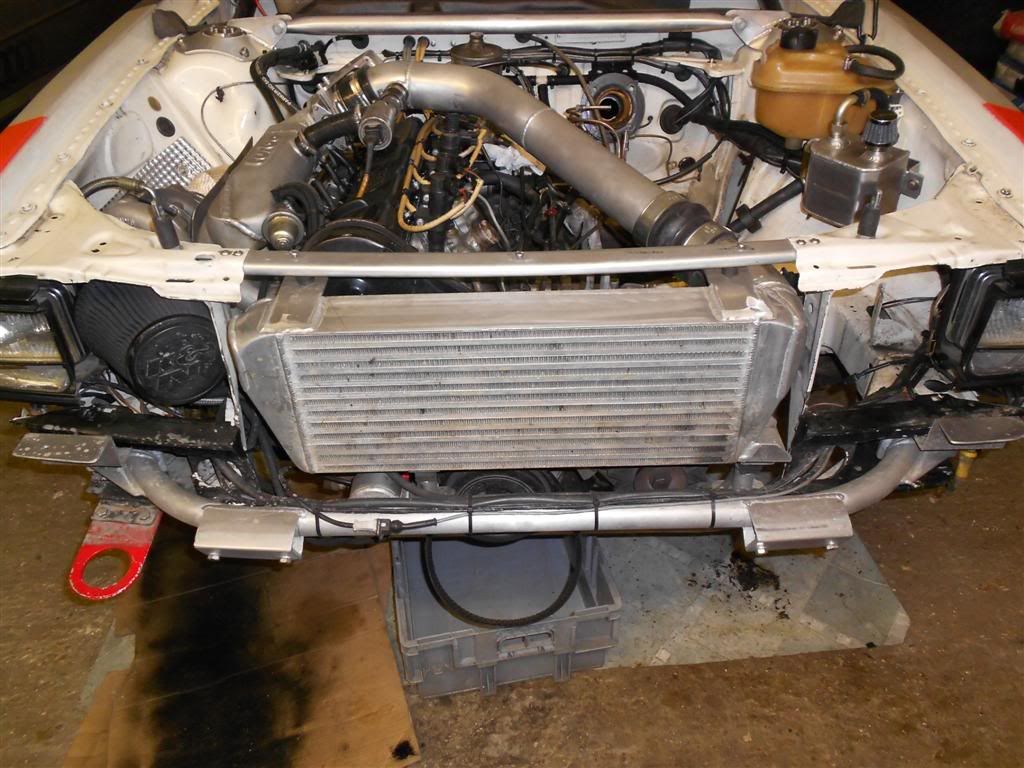

Part of me wants you to drive the sport around without bonnet and wings to show all the hard work off lol.
You could depending how far you move the engine back use a brace bar and intercooler at the front to join the two sides together.

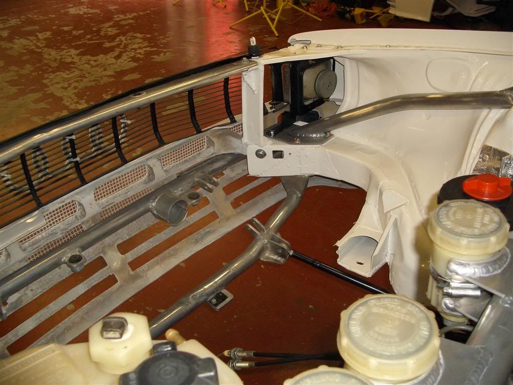

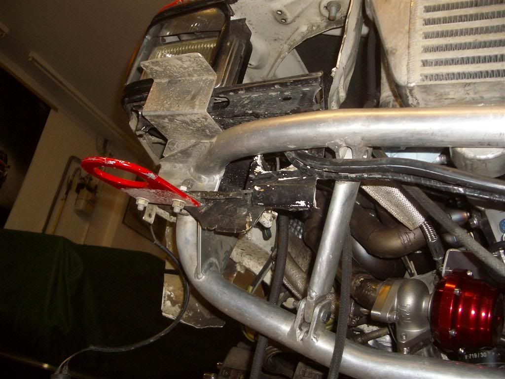

Here's a picture of a Group 4 shell that was being rebuilt at Sooty's when we visited a few years back.
And couple of ours (plenty more if you need them).
As Brian says, if you go the front bar route, you don't need a front panel and the engine comes straight out the front on a trolley jack.
