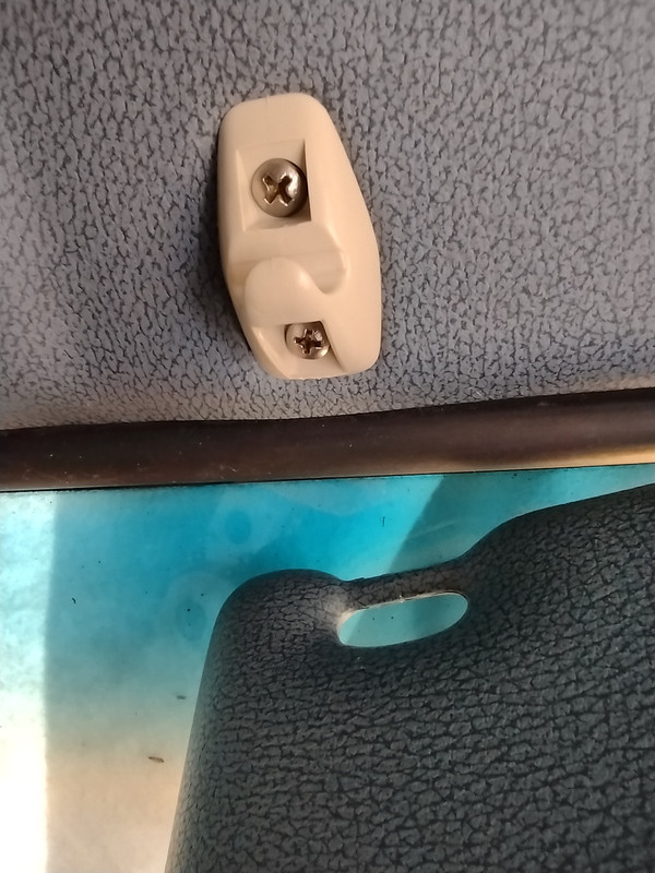

I bought some MK2 golf ones, they are very similar and much cheaper. You just cut the lug off the back and drill a new hole. Just need to paint mine blue at some point!

I bought a pair of mk2 golf ones for around £5 but left the lug on. Only screwed in on the seat side, seemed to fit. I did look on etka and it appeared to only use one screw so I’m now wondering if I need the second screw…

I used a
Golf pair. I needed to enlarge the gap very slightly for the visor to clip in but otherwise is fine.
