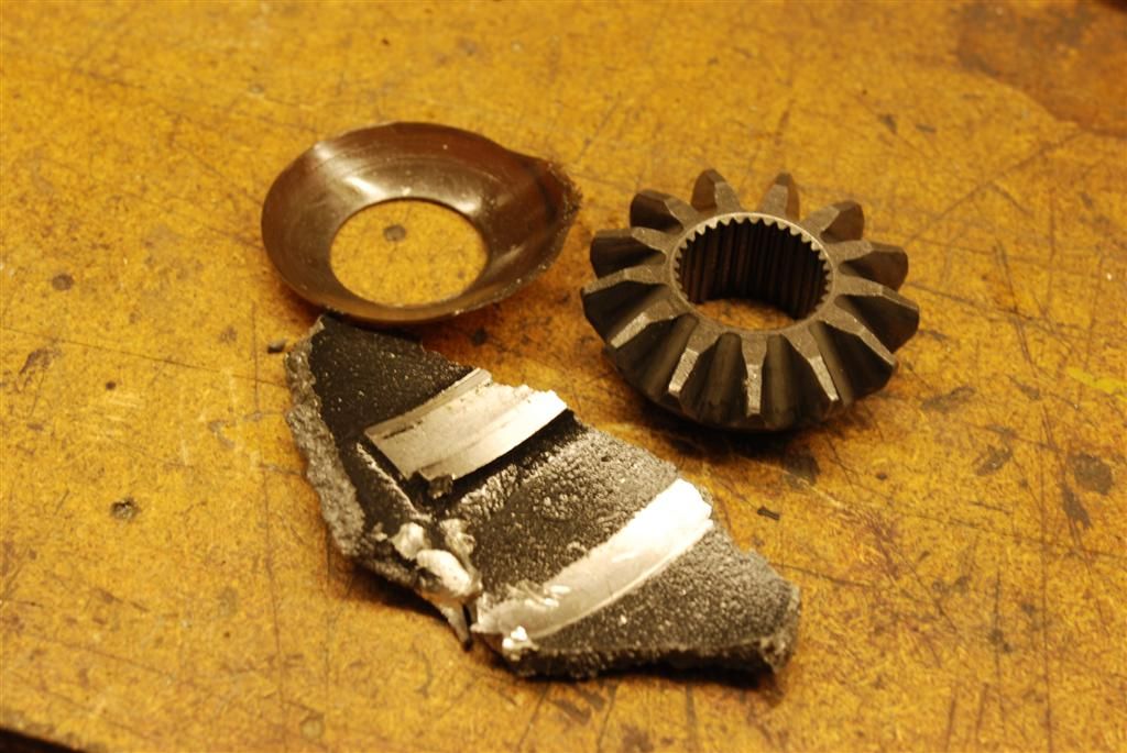

On my second practice run, braking and changing down to enter the complex at Gurston, I heard a bit if a bang!
Out of the corner I had no drive, so came to a halt. After being assisted of the course and into a safe position by the marshalls, one of them handed me these bits....
No further investigation required centre diff fancied a look at the outside world.
Also explains the trail of oil up the middle of the track .
Looks like another gearbox change .

Ah.... That looks broke does that...

Thats not good news Tim, so much for these box's being bomb proof..
