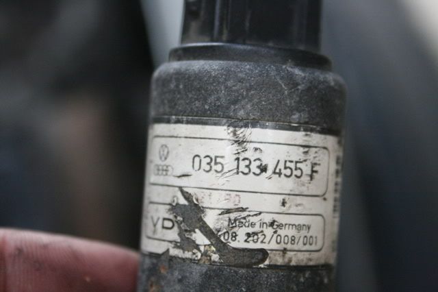

OK, the one off the 100 turbo didn't fit!!! Different plug.
I might just order one off ebay and try that.

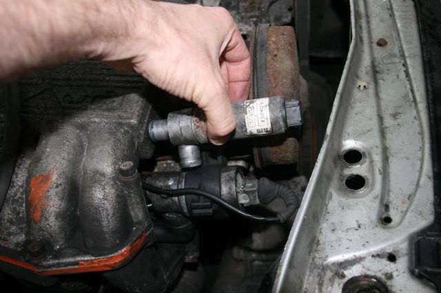

Old 17-06-08, 08:09 PM   #12
Got a new ISV.
No change....
Bugger.
I will try cleaning out the throttle body again (but not tonight......)
Any other ideas?
