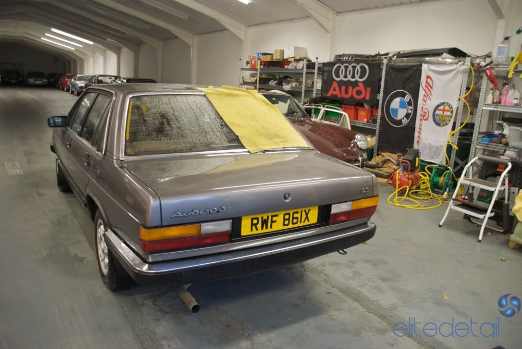

First up, a quick dousing of Valet Pro's Orange pre wash then out with the Gerni hot pressure washer and some Valet Pro Car Shampoo through the product feed line to give her a good soaping and wash down. Then a rinse of cold water and then in to the unit for a few befores.

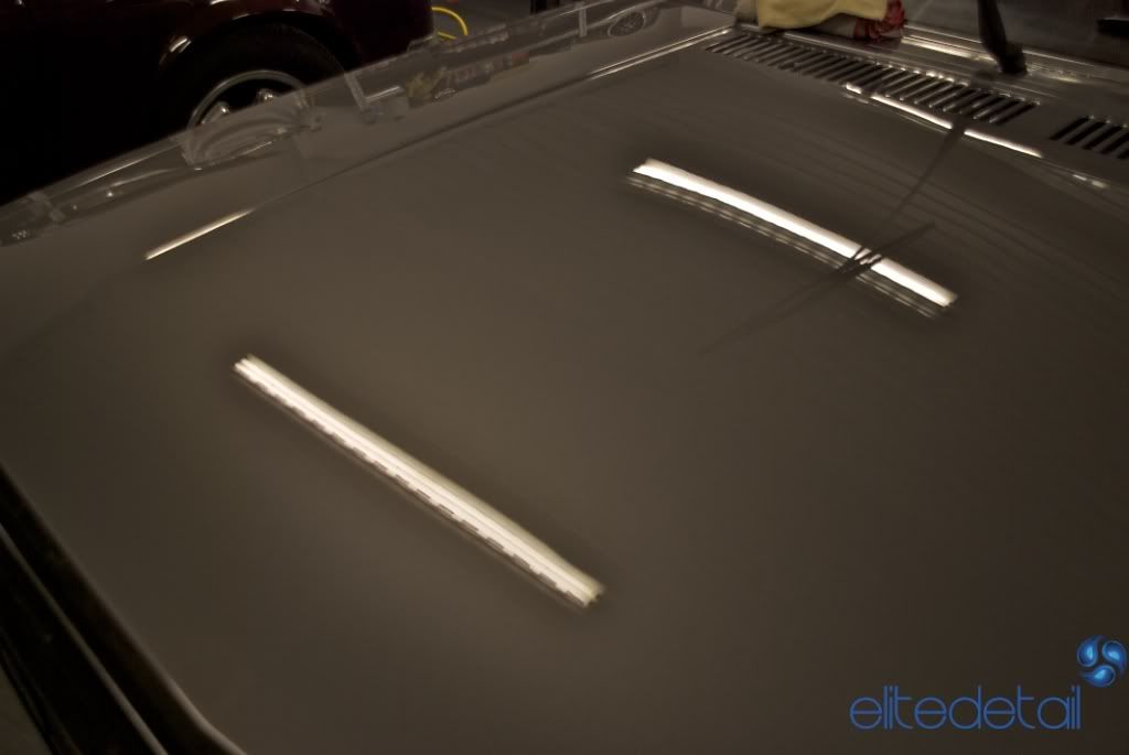

Hard to pick up in the pictures, but let's put it this way. It's 27 year old paint which has probably never had a proper polish in it's life!

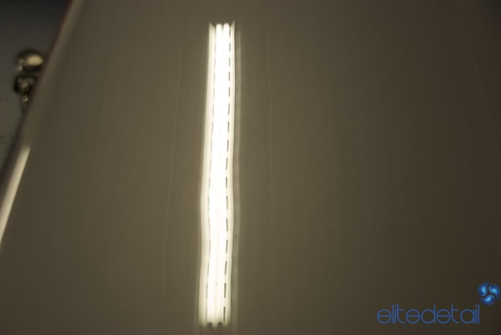

then the car was clayed. Again probably the first time in 27 years!
This was just from the boot lid.

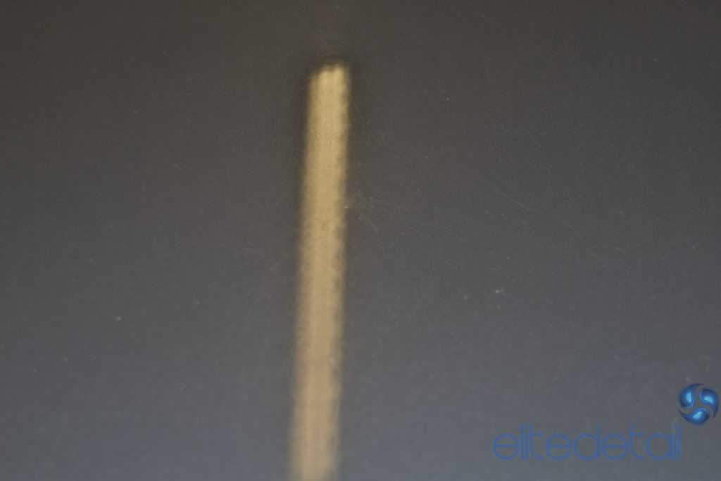

A few of the areas had a large number of RDS and cat scratches and some etching and these had a few extra passes of the fast cut plus and got rid of about 98% of the marks. There are still a few RDS, but given it's 27 y/old paint, it's probably looking better this afternoon than when it first left the factory! After that, I have gone over her with lime prime, but as yet, haven't put any wax on as I had to get stuff ready for a meeting in the morning.

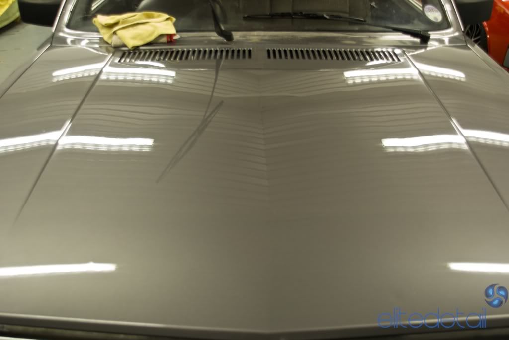

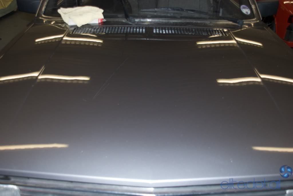

Boot lid afters:
Bonnet afters:
