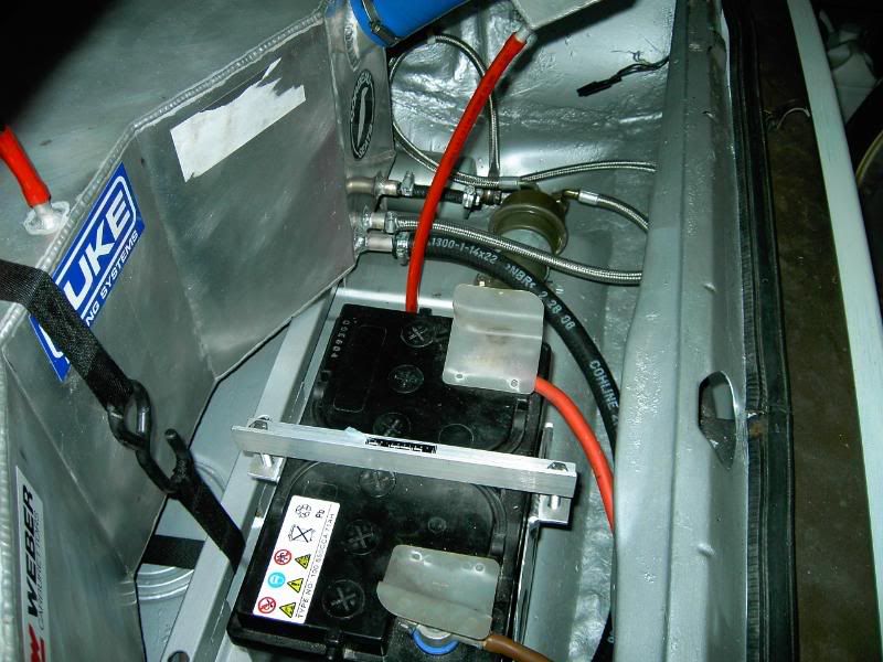

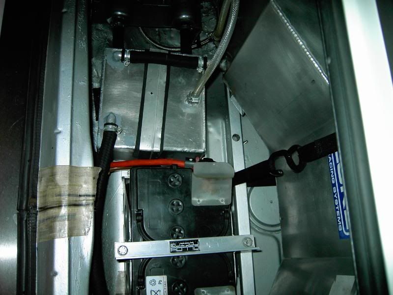

Here are some pics of the tank in the back of my CQ..

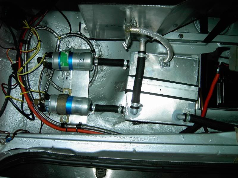

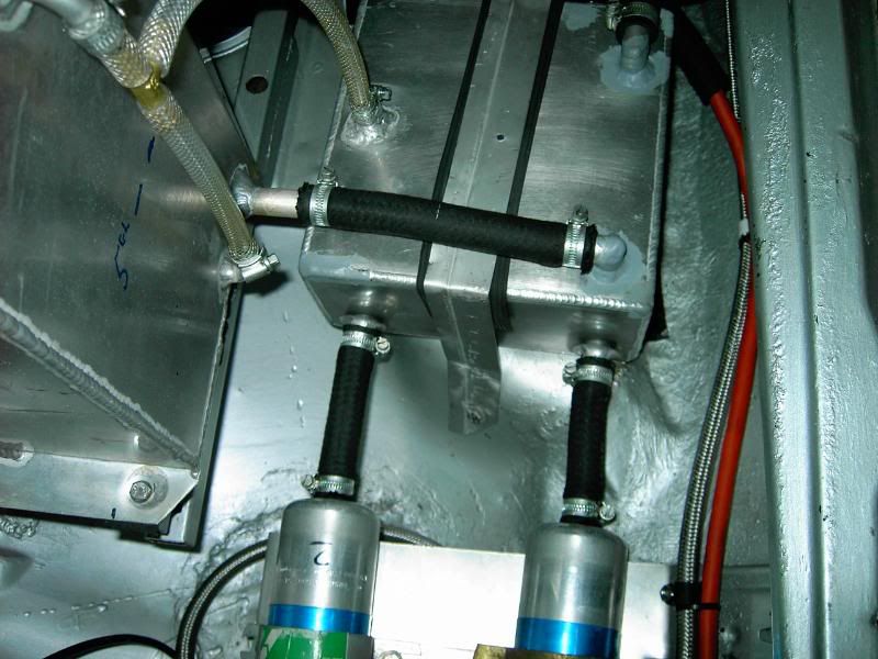

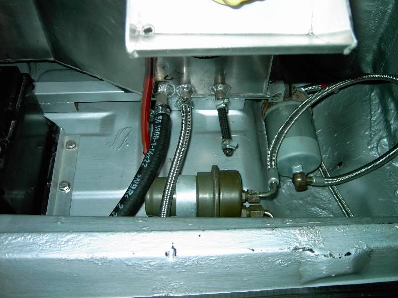

Heres the new set up with swirl pot..
I used 10m breaded high preasure fuel pipe and for the feed pipes to the pumps that was from memory 15m high preasure fuel pipe..
