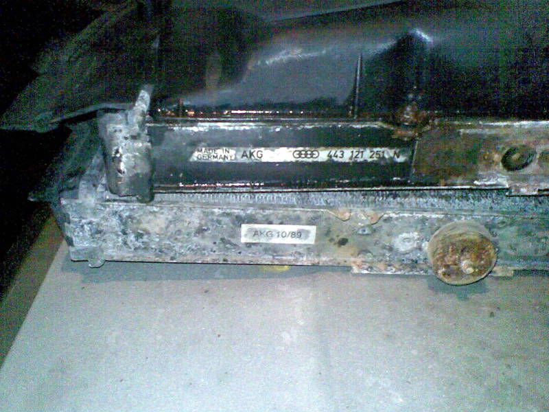

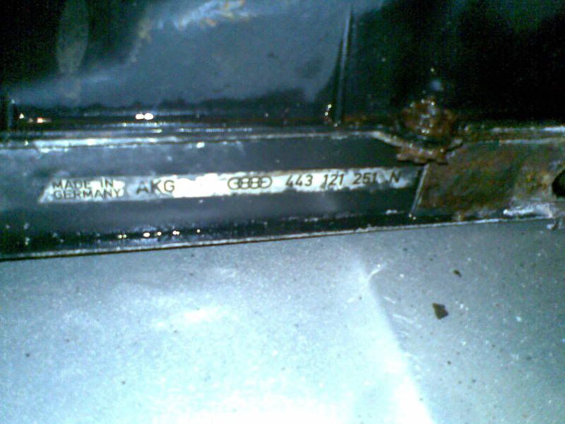

Here is my radiator: part no 443 121 251N

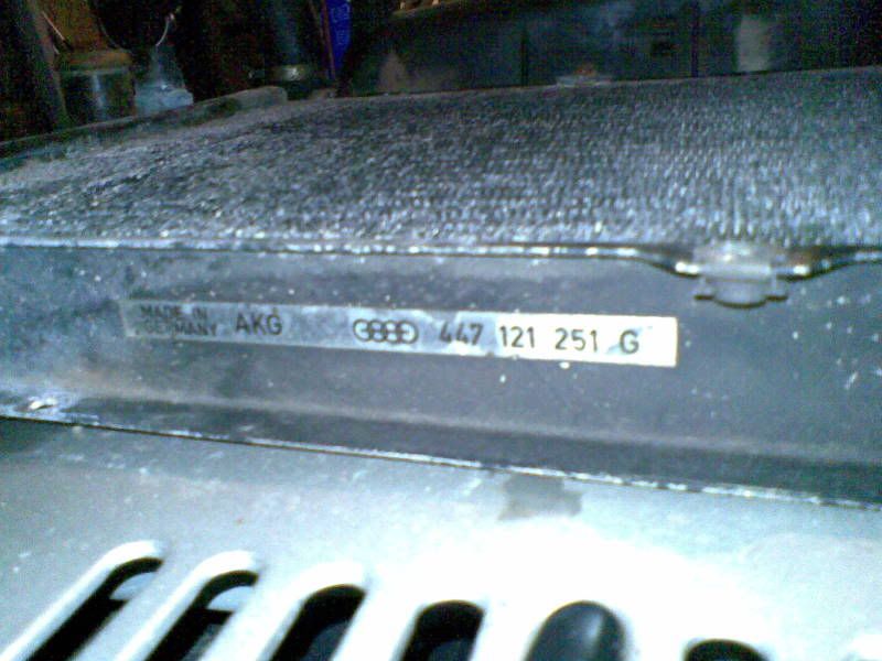

Here is the radiator off the 2.5 part no 447 121 251G

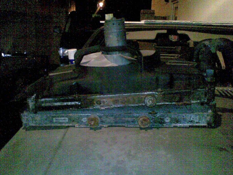

Putting the two together, they are slightly different.

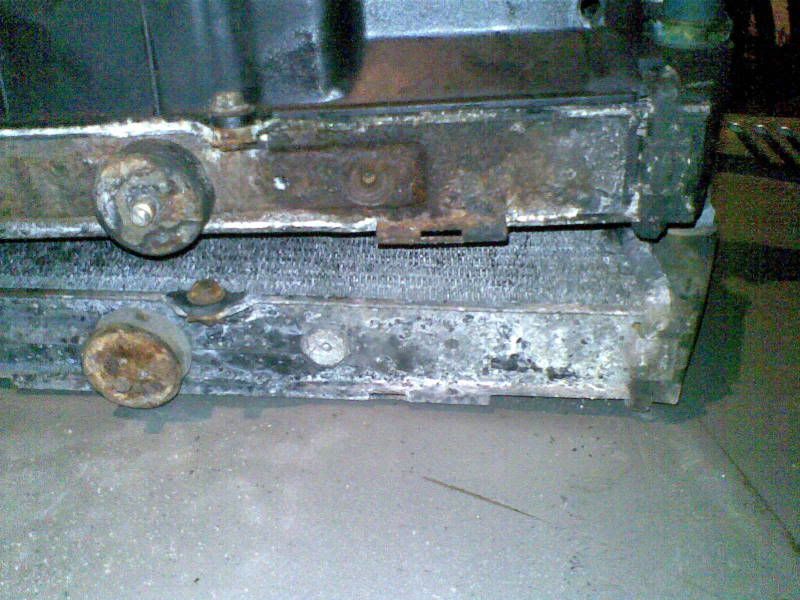

The overall sizes are the same (from the edge of the cowl to the water pipes), however on mine, the fan cowl included the contoured piece to fit inside the wing, and on the 2.5 one, the contoured piece is part of the radiator.
However, if you look at the mounting holes they are offset on the 2.5 so if I fit that radiator, then it will be offset from where the mounting holes are on my 100.
