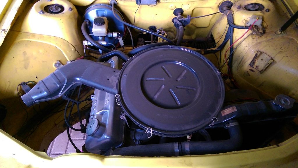

Default Solution
Sorry for resurrecting this thread, but I might be able to help someone out.
I found a suitable brake booster for my car. Turns out the Porsche 944's booster fits almost perfectly. With the stock brake booster the brake pedal sits a bit low, but the brakes feel great. Extending the rod that goes into the booster should solve this.
Hope my image is added. I'm a bit rusty.
