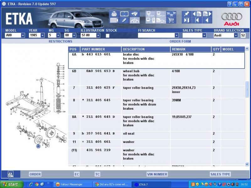

A few pictures
Old 29-10-13, 08:15 PM   #5
All mine,did.
KARL.
