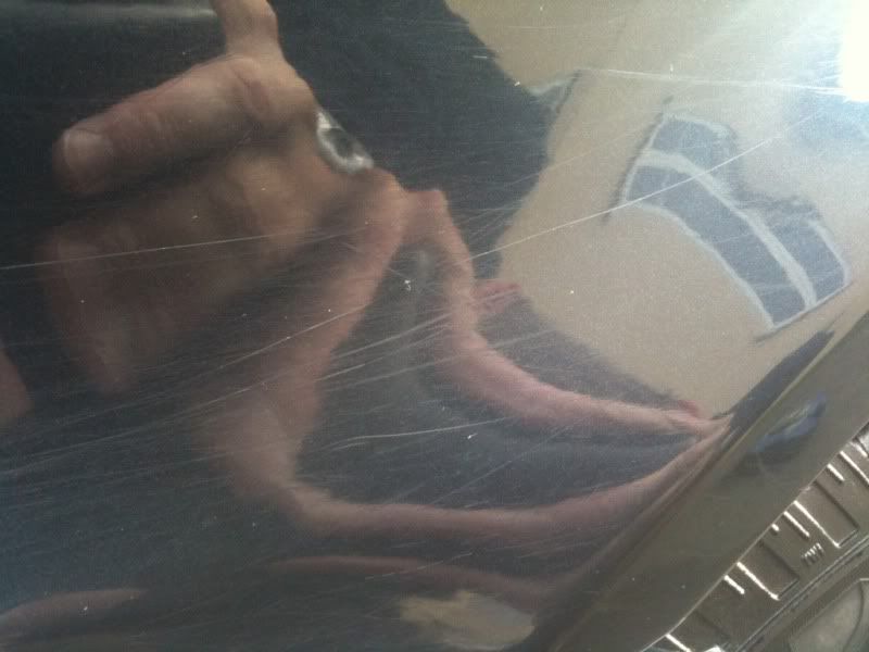

I did the following to one panel on my B4 80 as a tester.
Wash with Armorall detergent.
Dry.
Clean with some tar cleaner stuff I got
Wash again.
Clay with lots of Meguiars quick detailer. (got rid of lots of ingrained white specks of paint).
Then I got my random orbital polisher out (Halfords one I think).
Used Menzerna Power Gloss, several times, both hard pressure and light pressure.
Can't get rid of deep scratches.
As you can see, the rest is nice and shiny.
Do I need a more abrasive compound?

WHAT polisher and pad are you using? is it one of the two handed jobbies and a wool mop from halfords, use some g3 or theres a good menzerna one i use, number escapes me
Old 11-10-11, 03:03 PM   #4
it is a 2 handed one like this:
http://www.amazon.co.uk/Superline-Po.../dp/B003MEV8NE
Was using a blue pad, not a wool one. But I have a wool one. DOes this promote more heat which breaks it down?
Think I might need G6!

they aint great tbh them polishers for what you are wanting, ive got a g220 megs and thats half decent , you need a decent agressive pad either 3m or sonus sfx , there is also a knack to doing it too.....and it takes a while on each panel, i put a big scratch on mine with my watch at adi last year and that took an hour to get out and i spent 3 hours on the bonnet this year .....have a look on detailingworld or bug coxxy
