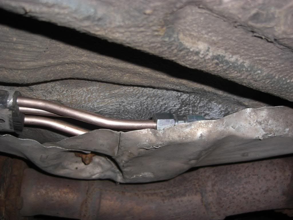

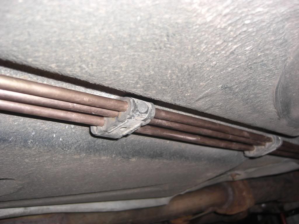

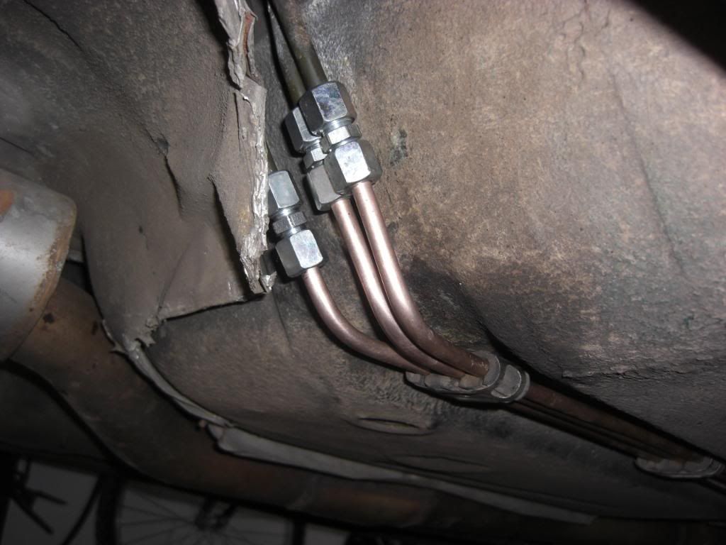

I've done the repairs now and I'm really chuffed with it. Have a look at the pics. What I did was, to simplify the repair, I only replaced the rotten section of pipes. I used some great compression joiners, which meant that I didn't even need to flare any ends. The compression joints are tucked away out of harm and were really easy to fit. total cost of parts was £25 for fuel line and £6 for compression couplings. ...mega!

Replacing the lines entirely (and safely) is a better option of course. The pictures in post #5 are textbook stuff. Really neat job.

what size compression fittings are they (10mm???).
Did you put PTFE or any jointing compound on the olives?
