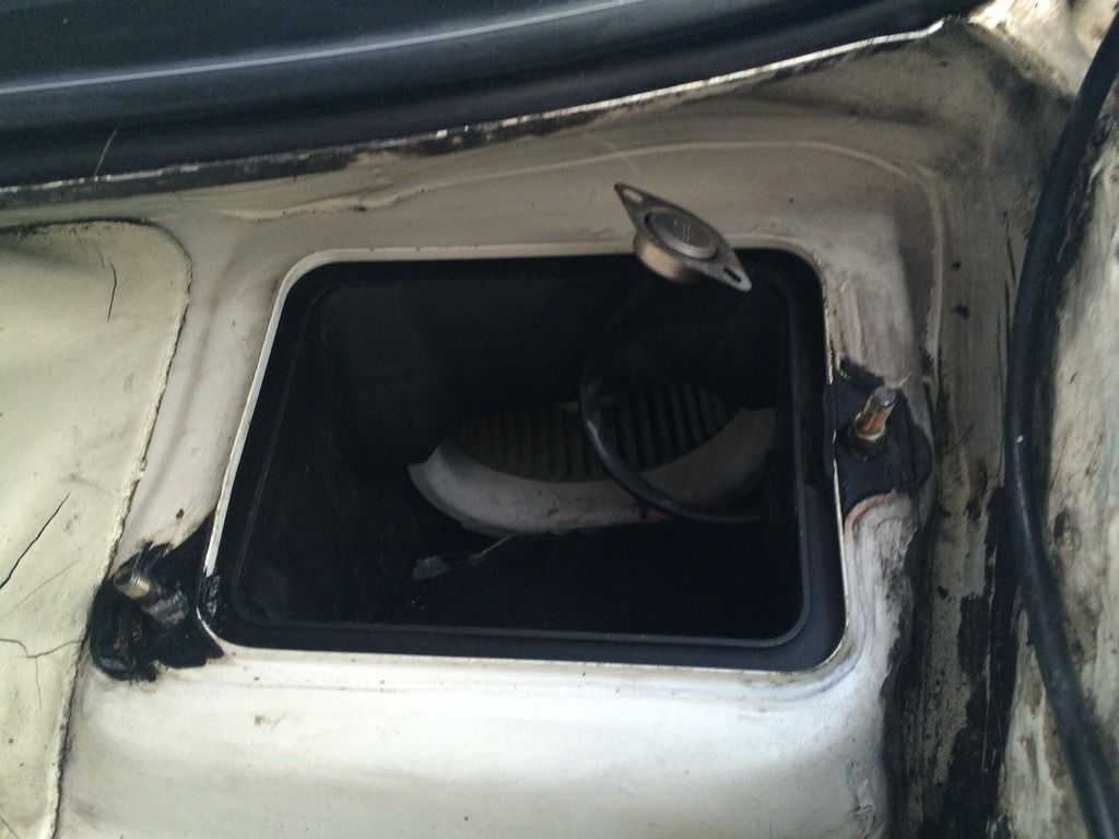

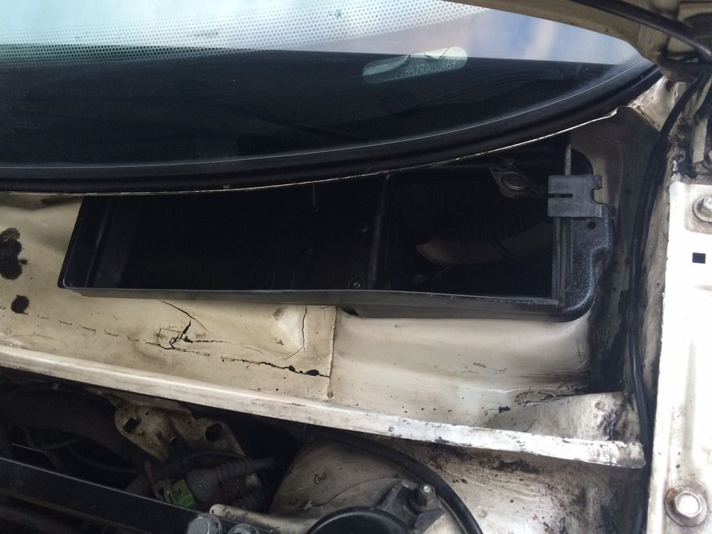

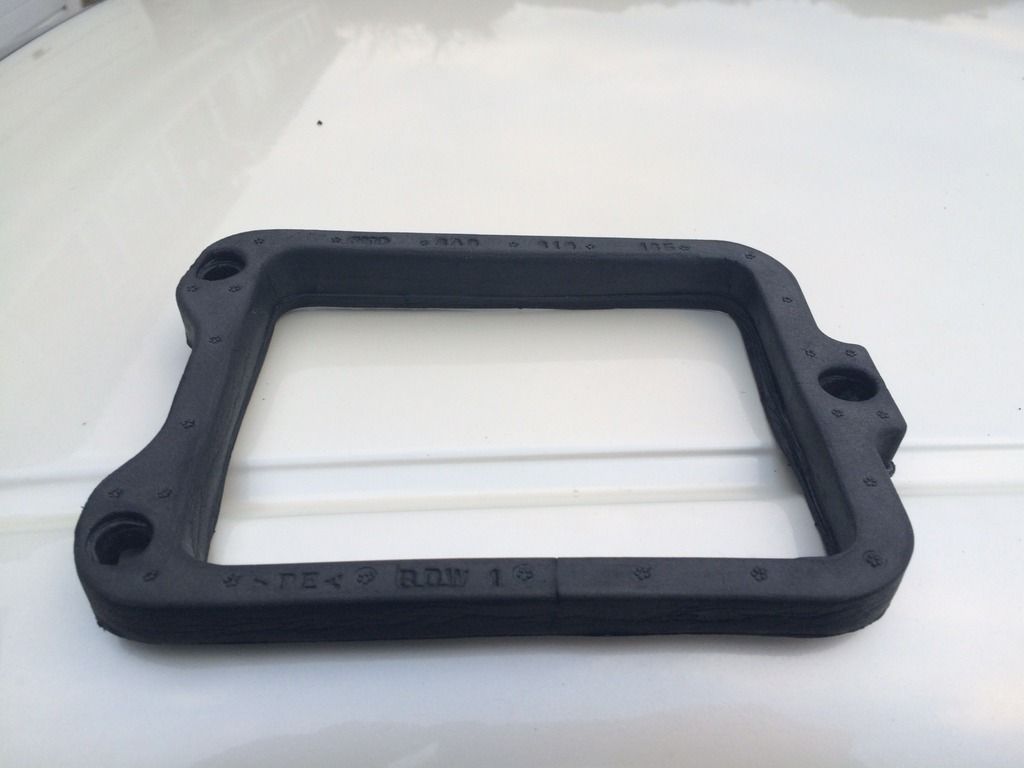

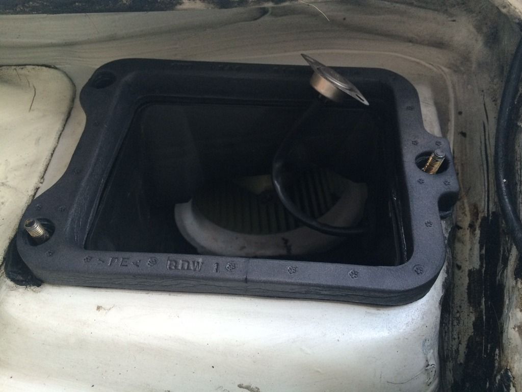

spent some time on my b4 today to try and sort out the leaks, I'm starting t think I've bought an Audi colander it's leaking from everywhere ,sorted the back out now, new gum on the rear lights and reseating the boot rubber, now to the front, the door seals are leaking so i think I'll have to locate some new ones but it's leaking from behind the dash as well 'great'! After lots of water and trying to squeeze under the dash I arrived at the pollen filter housing it was fairly dry?? So I turned to using water dyed green and yes it was defiantly comeing in around the housing, taking it off I revealed a sponge gasket inside the housing which was a little tired looking( don't know if I could get a new one?) but also realised that it had been off before and the bolt to left had been over tightened and cut the metal and the water was coming in around there as well. So a new washer, some silicon, tightened it all down I'm hoping that has sorted that leak (fingers crossed)a bit late to try it
[IMG][IMG][/IMG][/IMG]
