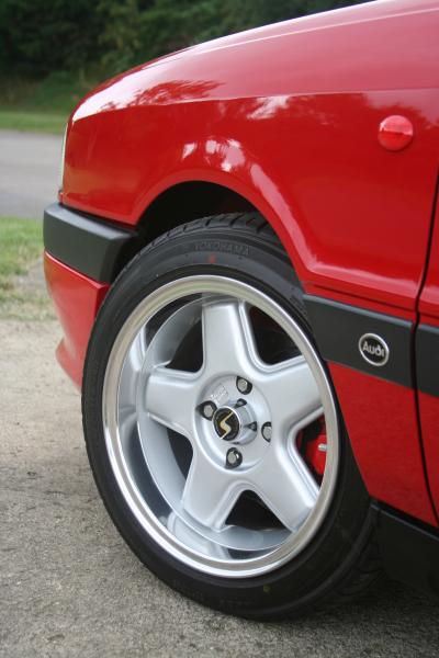

I'll have to look as im not 100% sure i think they could be +or- 28 et. If you look at my album you'll see
the wheels
What tire size do u have on thos? :tp:
nice wheels.
http://www.classic-audi.co.uk/forum/...&pictureid=429
Old 10-04-09, 11:20 PM   #22
vag80
vag80's Avatar
Location: Bracknell
Posts: 1,967
I'm running 195/50x15 front 205/50x15 rear. did run 205 on the front but they rubbed with the old
suspension. It now has new suspension fitted which is now 60/40 with -10to15mm upper spring caps
so will have to see wot its like once it all settles.Car back no road at the end of this mouth.thanks for comment on the wheels

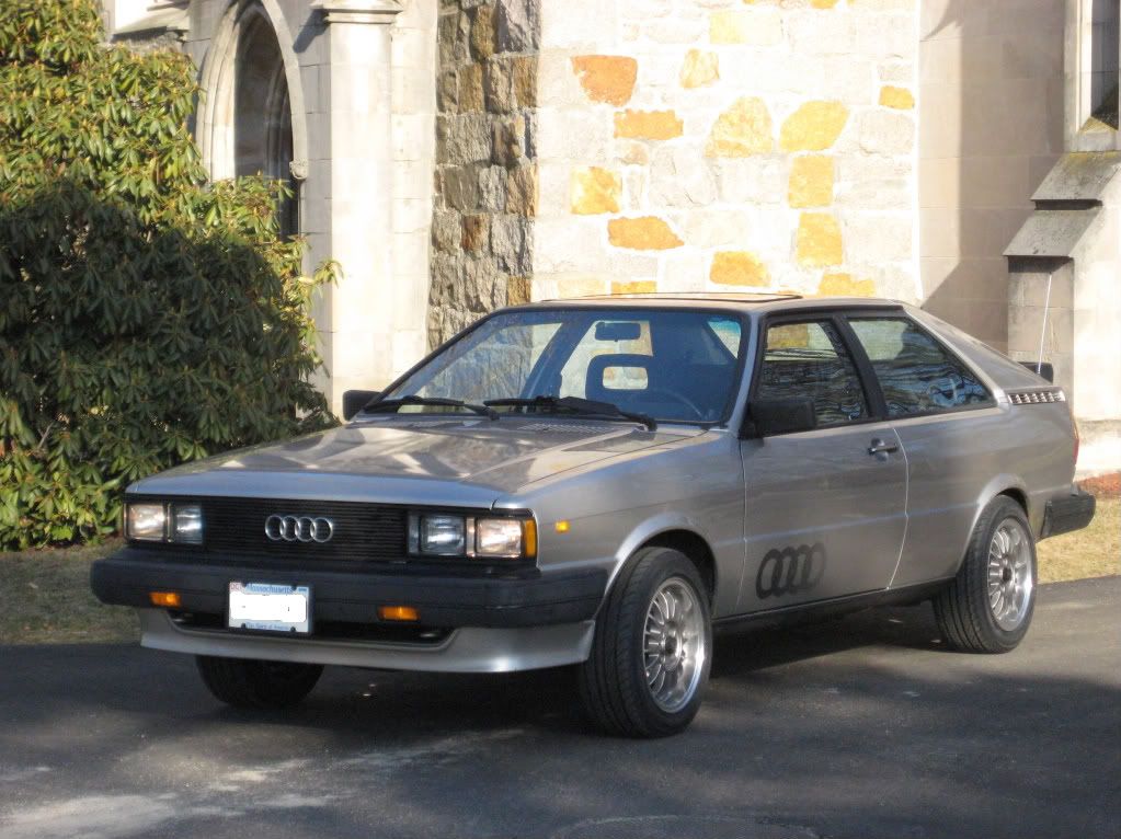

Old 11-04-09, 11:21 AM   #27
Gaz. Just so you know, for a point of reference. My 1983 Coupe GT had factory Ronals which were 6x14" et 45. They were tucked pretty deep under the arch. I upgraded to 7x15 inch et28, with the lower et and wider wheel I've exactly filled the arch and have plenty of internal clearance to the suspension. I mounted 195/55/r15's Yokohamas. I think given the tolerances 205 would be too close. The 55 vs. 50 give me a little extra cushion, which I've been glad for. The Coupe is definately smooth to drive, quiet, and sure footed. That being said she tracks a bit twitchy (not bad) which commands good suspension (lowering considerations for later)and alignment.
Vag80 are you saying the wheels on the Audi in your Album are Borbet A's, or is it too early in the morning for me? Probably. They look like Revolutions. They look great by the way. I'd like all the info on them spec-wise for my records. Cheers.
Old 11-04-09, 11:31 AM   #28
Here's the Z-Coupe with 7x15et28's.

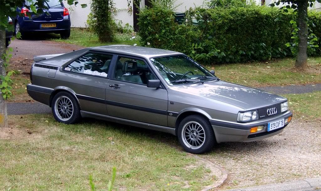

Old 11-04-09, 05:09 PM   #30
A Coupe with 7x15et42 R8 small lip 4x108 PCD
A Sedan with the same, tires maxed out to 205
Same, not the center caps "Ronal"
My Coupe with 7x15et28 R8 large lip 4x100 PCD
I dont know how 7.5 or 8 inch would be, but probably headed into widdening the wheel arches as per the Ur.
