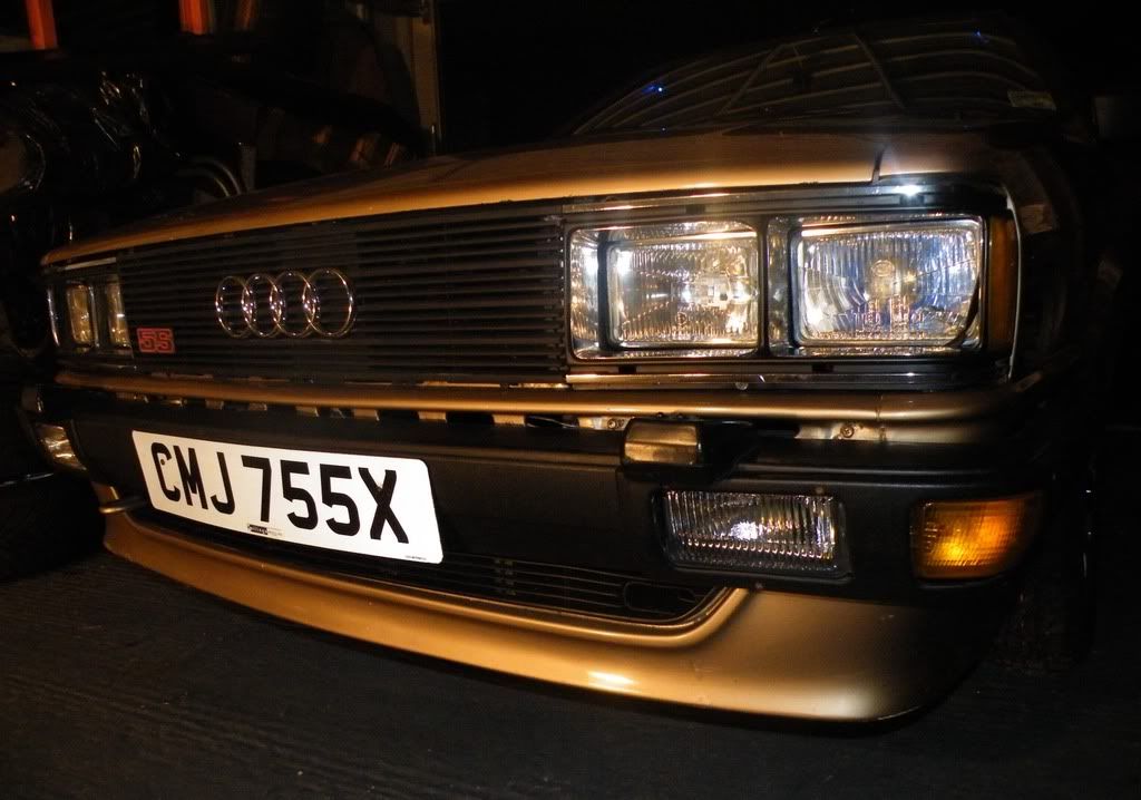

Had a similar problem onmine after a non genuine wing was fitted. When I had the bare metal re-spray 5 years ago it got replaced for the genuine article...that fitted and sounded better when you tapped it too.

I thought all the experts said this was a Bonnet issue????????

adjust the bonnet

Originally Posted by Gaz View Post
From these two shots I would say the wing is out. The leading edge of the bonnet seems to track the top of the grill quite nicely with a parrellel gap all along. Whereas if you look at the edge of the wing over the headlamp unit it looks like its not been fitted up right. I have a similar sitaution with mine on the same wing and I know it's had new wings and more than likely patterns.
But I am happy to live with it for now

Looking at the pics, other than the locking pin needs adjusting to lower the bonnet down to align with the wing, the bonnet seems to align with the section below the windscreen suggesting the wing has a part to play in this too. Bonnet adjustment will help but if you're fussy, adjusting the wing may be necessary or a new wing as in my case...
