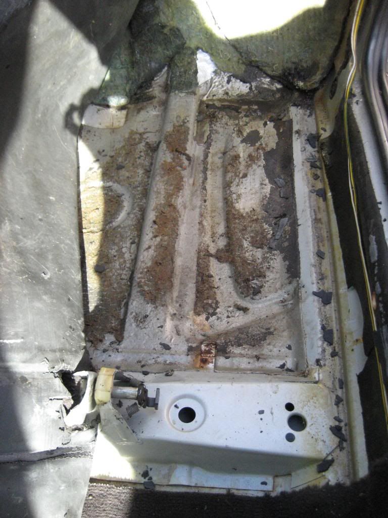

So. Hot sunny day. Carpet pad still sopping under drying carpet. I broke down and took the seat out, trim and carpet. The pictures shows the most likely point of origin. The small amount of water appeared after I hosed the vents and seams at the top of the hood, THEN I pulled the car up to get out of the puddle (To dry pavement). Just after I pulled to a stop I saw the trickle shown in the picture, forward movement may have pushed it back.
The area around the heater bits and firewall seem to be the culprit.
I'm looking for additional thoughts on points of origin, given the flow of water appearing at this little vent scoop on the floor.

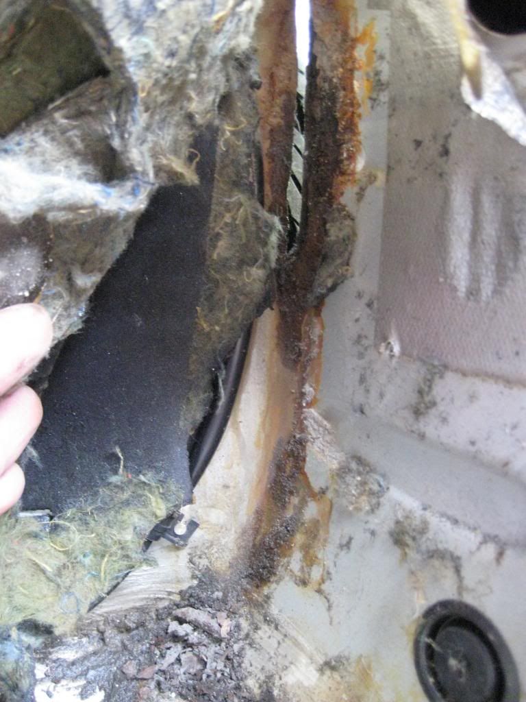

So I chased the leak further up, under the front carpet to the corner of the footwell.
Uuug.
Anyone have a "goop" recommendation for resealing this area after cleang it up and fixing the steel with a torch and a patch. There was some kind of factory sealant on this area, seen best from the wheel well. The 3rd picture, which I put something colorful inside the car so it would show.

Hopefully going to drive to my Dad's this weekend to fix the leak. 3 hr drive, hopefully not pouring rain, which adds to the difficulty when I arrive.
Perscription calls for, wire wheel, sand blast, rust inhibitor, make patch, weld/epoxy, seam sealer, and paint. Then decide on replacing rotted padding and lay it all back down with adhesive spray and refit the interior. Harummmph. At least I found the leak.
