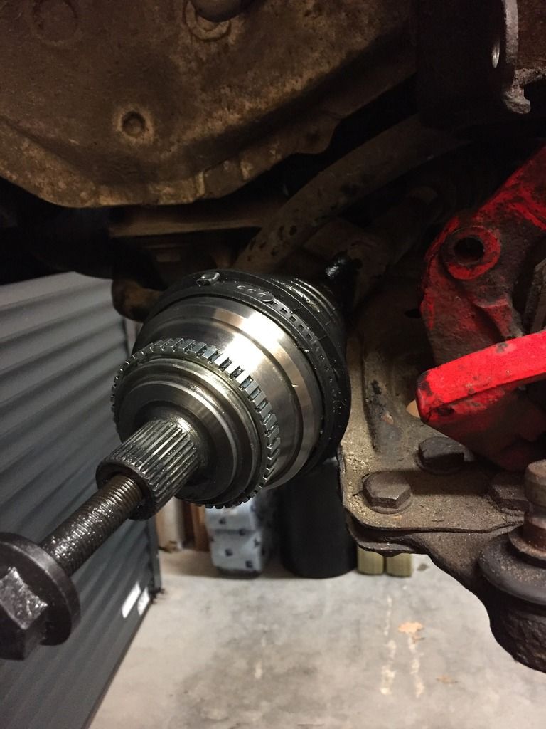

Some pics… forgot to take more..
disc and calliper off and out the way..
The abs plug on the offside, this is after I’ve moved the expansion tank out the way..
This is the grommet and cable on the wheel arch side having been pulled through..
Old cv joint off…
