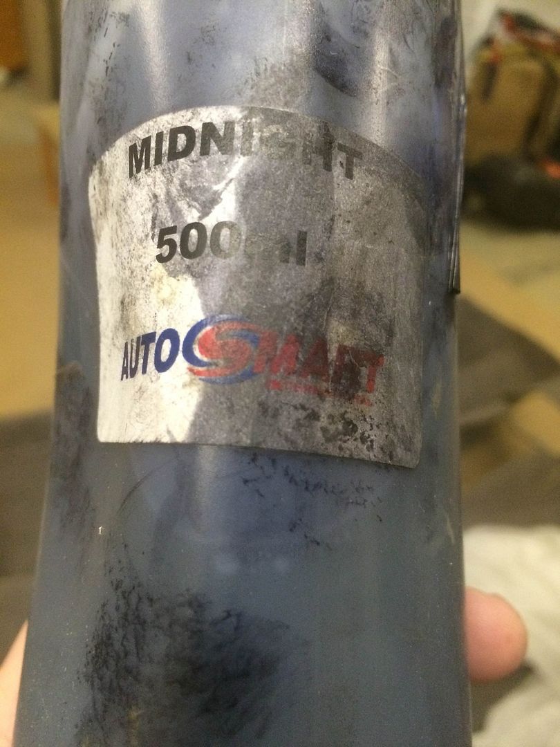

Found it, here's the stuff I was talking about. Auto Smart as far as I can make out, I had a look at ebay but I can't find it so it may not be available anymore.
