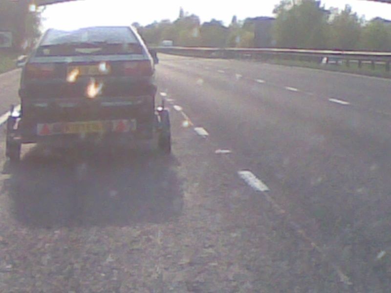

Got it delivered tonight.
bargain price.
Won't idle, but never mind. Must be something simple.
Currently stored on a farm for the next couple of months, so it won't be there on Saturday.
