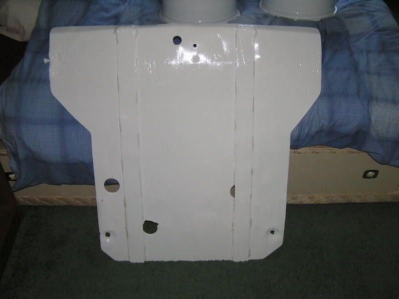

I had a nice delivery this morning, the first set of rims are back from the powder coating along with the sump gaurd
They may not be a nice as the Audi rims but they are getting very rare indeed
why white they will soon be poo brown when you get it on the road

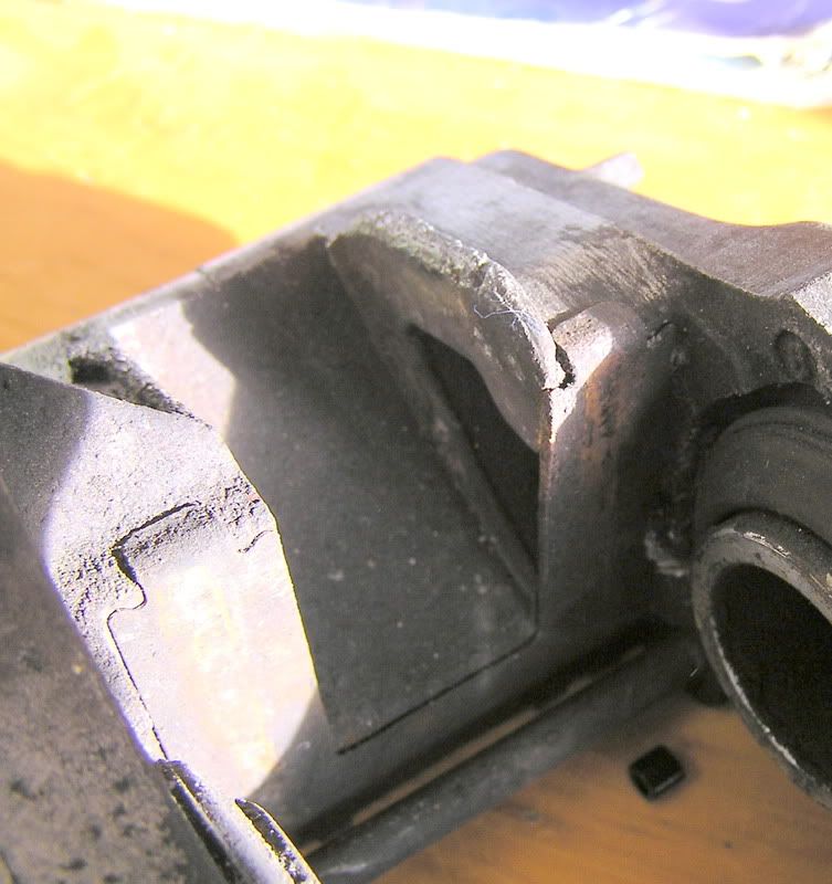

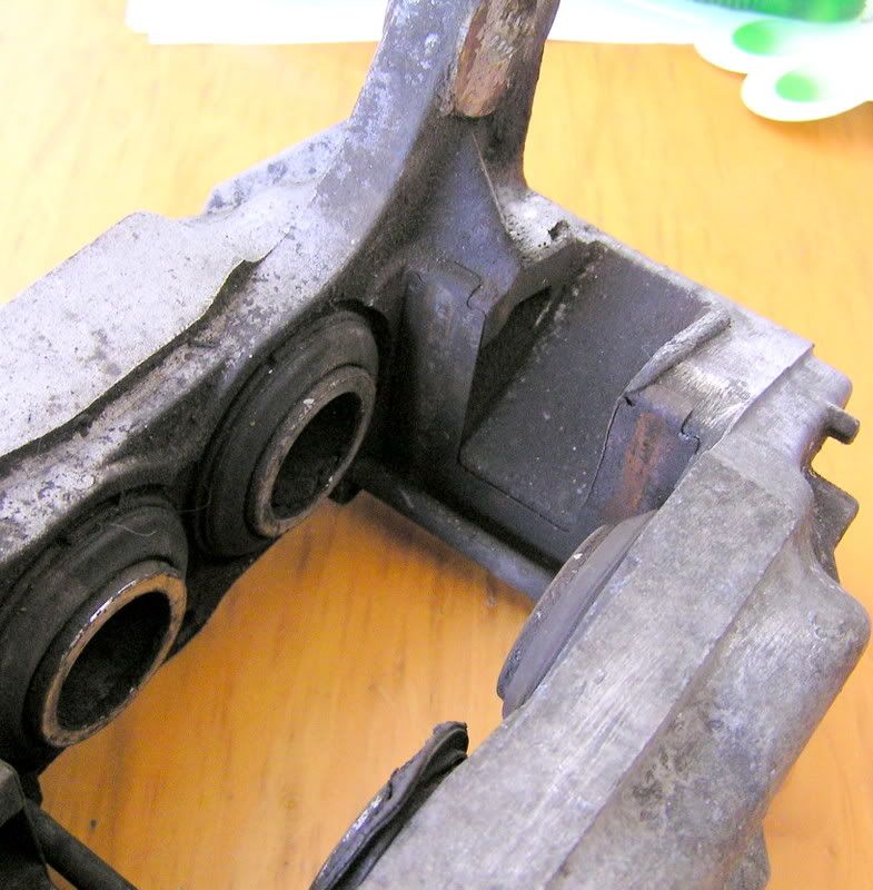

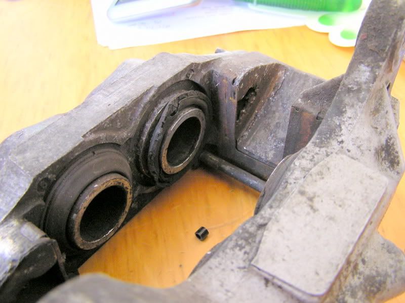

As you can see theres a bit of damage to the caliper as the front wheel bearing was fooked and the hub has wobbled around a little, need to remove the burring and strip and replace all the seals

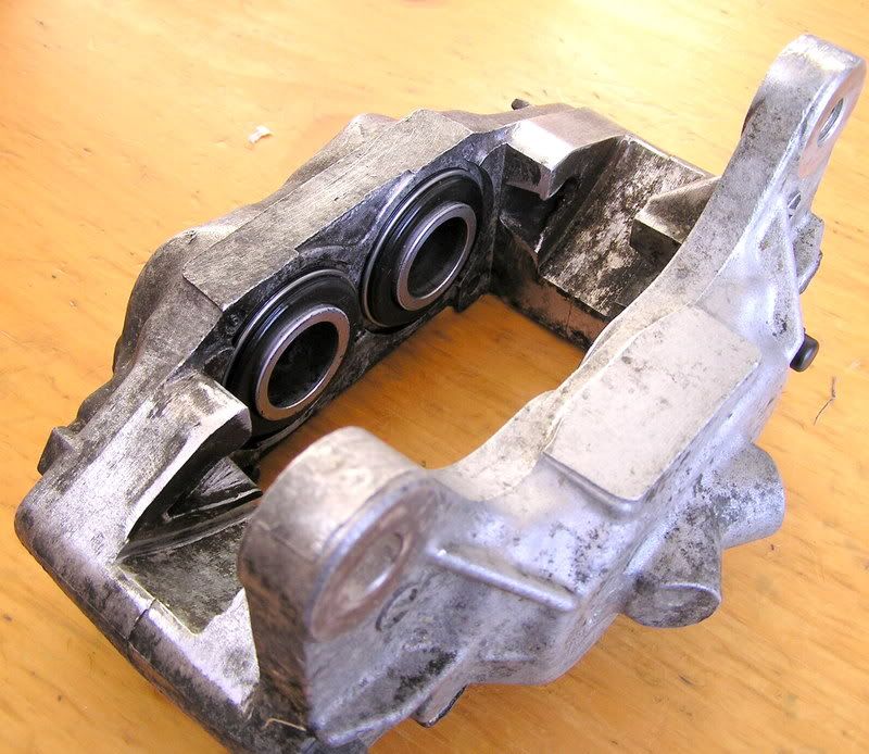

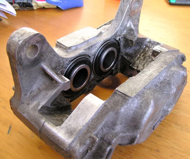

Caliper's have been stripped down, pistons polished and the alloy filed back, new seals fitted and rebuilt, I have decieded to keep them just in the plain alloy instead of painting them.
Only 3 more to strip and rebuild

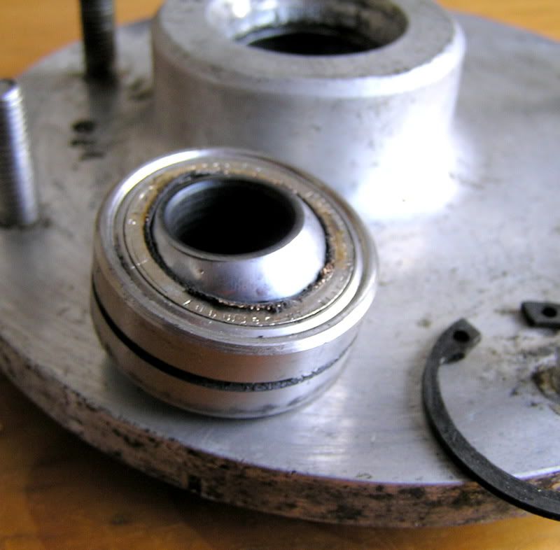

The next little job we have done is rebuild the top mounts, As you can see these bearings are totally shot to fook, theres about 4 mm of play in them, 5 hours searching the tinternet and we managed to find the same make and the same size and spec as the original ones, 10 days later and £62 lighter,these arived from the Fatherland.
Old 24-01-09, 05:12 PM   #99
They look better Nige. Are they press fit into the housing or held in with the circlip? I'd guess with the circlip.
