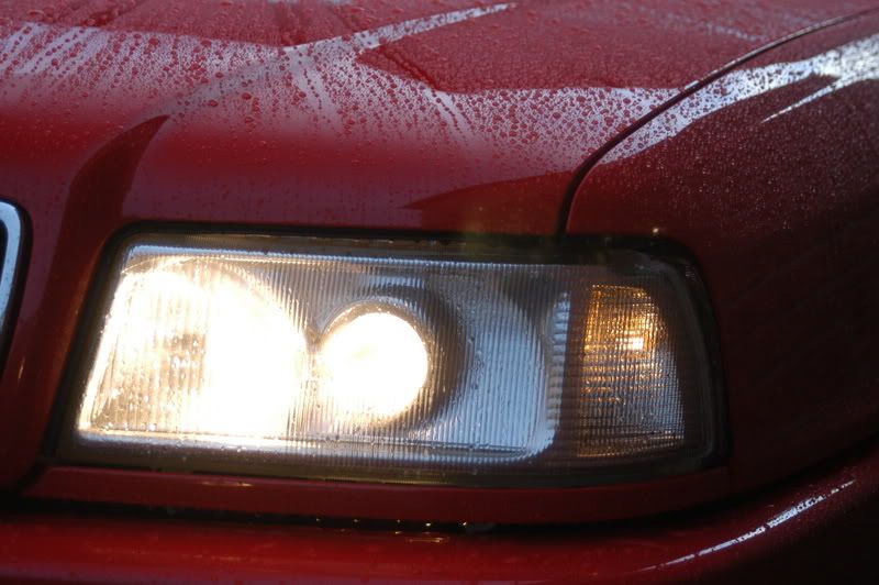

Hi!
Anyone knows where i can buy this light?
I think it is from a 90.. But not sure!
Kind regards

thats a 80 coupe headlight.Also on the 80 cabrio
here's my old one
if you need one ring Will on 07784549552

Has a Homofocal lens, or projector beam as I have heard them called........

Also found on ABY S2's, known as an Elipsoid.
Expect to pay £200-300 for a pair 2nd hand!!
