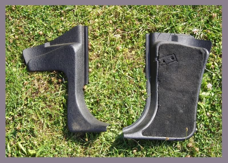

Hi Rich, I know we keep on about them, but are you sure the door membranes are good. They really do prevent the water that runs down the window glass from getting to the back of the doorcard (which is inside of the door rubbers)...
Also, check the door rubbers are good, and tight, especially at the lower part of the A pillars, there's a bit of trim that sits down there, lips behind the rubber...
These bits...
Any rain that runs along the wing as you drive, is pushed into the A post/Door gap and blown onto the rubber. If the rubber is even slightly raised, it'll get in, and drip down onto the carpet where these two pieces of trim are.
VBR
Ian

4) the wing edge when the door is closed is water tight all the way up until about 3 inches from the top of the wing/ door gap, then water was coming in, further investingation revealed there IS a hole about the size of a 10 coin at the A pillar where the door closes onto the edge of the wing,
5) the windscreen is 100% watertight BUT the thin gap between the wing and the windscreen surround IS letting water in. I suggested running a sealant into that panel gap and prevent water getting in, so thats what he will do.
6) on the inside behind the plastic trim Simmo shows in his post above, this is where the water is coming in so thats also been sealed as well, the drain hose from the sunroof wasnt exiting but going into the sill then out under the car/ some of it INTO the car.
