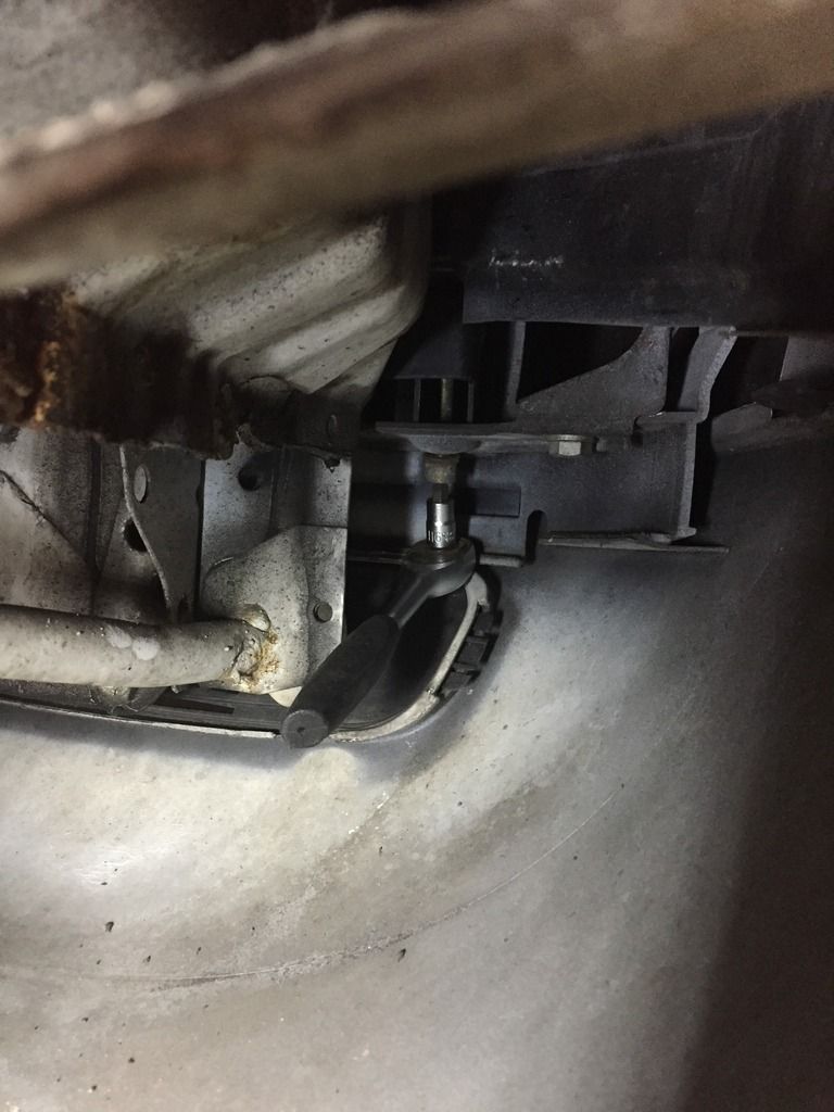

If I manage to secure a v6 bumper.... I've been looking at pictures and I'm thinking there is a difference as to how it attaches. Mine has the bolt that goes up vertically behind the two lower side grills. But looking at a picture that I got from FB, it appears to be different..
Would be good to here from people that have done this and can shed any light on the matter...
This is the back of a v6 bumper..looks to have two screws per side horizontally perhaps..
Here's mine when I was taking off the vertical long bolt, one each side..
Car was put to good use yesterday!

I'm happy about the side brackets, as I'm sure they are the same or very similar, but it does seem that something is required for the front ones..
Basically the v6 bumper and the s2 bumper aren't a straight fit on to my car...many obstacles being put in the way of this conversion it seems..

Thanks Mike... Looking at the pics.. The first one is on its side? And the second is looking towards the ground?
So going by that, I think you mean the brackets with the two nuts and the screw hole in it. (And my original long bolt holding my bumper on goes up through this threaded hole?) And if so will my car have the two holes for these nuts/bolts to go in to?? And where am I getting these brackets from?

I'll take my bumper back off and see exactly what's what. Yeh I reckon you are right. However the bumper in the picture isn't the one I'm getting its just a library pic.
