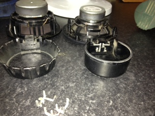

I decided to sacrifice an old Nokia 90 shelf speaker i had in the 2.2E, and a dud Haes door speaker I found in a box in the loft. The 90 speaker would not prise apart, but the bottom could be clipped away using a pair of cutters. The 80 speaker came apart by running a screwdriver aound the seal and then levering it off. What I found surprised me:
There was no gubbins in there at all?! Just bridging pins, and one more set in fact on the 90 shelf speaker than the B4 one. So: Game On! Time to bite the bullet and break open one from the car and get to work. I transplanted the 90’s pins into the 80 door speaker (another Haes unit):
Would it work back on the car? This time I used the connection at the rear shelf to test it, as effectively the Duo-Sound should think this franken-speaker was from a 90. It worked a charm, and cut out when the switch was flicked.
Time to whip the other door card off and make another franken-speaker. This one was a Nokia unit, which was appreciably harder to crack open than the Haes. It just seemed to have more glue on it. Regardless, once opened it was of identical construction, and it was possible to make another 90/80 hybrid by sacrificing another shelf speaker.

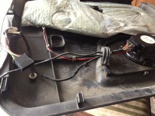

Next, deep breath back seats out, parcel shelf out, passenger side front seat out, centre console out, carpet lifted!! It was a case of relocating the shelf wiring down to the doors, extending them as required, retaining that crucial ground wire that loops everything together. I also ran that extra 5m phono-to-phono cable to take advantage of the Deltas front channel.
The door card loom took some fettling too, mine are the type with the box that covers the speaker, some B4s are like this, some aren’t I have found, anyway the upshot is they have a loom extension piece into the box so you can remove the doorcard without dismantling the speaker enclosure. I used the Duo sound loom I removed from my own car to make an extension by clipping it and soldering a female 4-pin plug onto it as per the Audi made one for the source wires:
