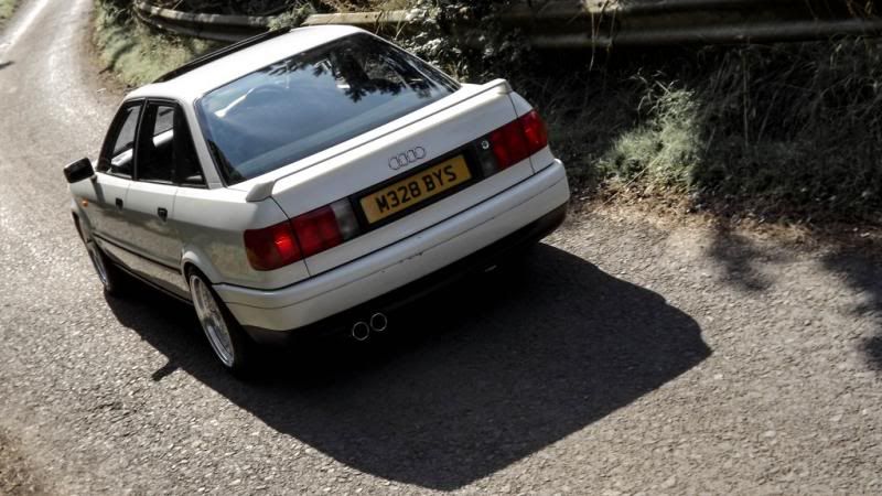

Originally Posted by shaun5 View Post
Cabriolet and coupe rear bumpers don't fit saloon / estate cars. Front bumpers fit pretty much through out the range (B4)
Ive still got a RS2 style cabriolet front bumper for sale if you are interested.
Can you send me a picture and a price please chap?

Actually re looking at that link the front is from a V6 as it doesn't have washers

That is a V6 coupe front bumper and an S2 avant rear bumper you have pictured that you want.
As above S2/v6 coupe front bumpers are the same, S2s have washer jets.
Coupe rear bumpers do not fit a saloon.

Whats this rear bumper from then? Anyone know?

S2 Avant rear bumper? So the estate ones fit?

S2 Avant, if you look at the black one and this one it's the same wide band through the middle

From an S2 avant in the UK, could also be a competition in europe.

I think the bumpers on the example you've shown are from a standard cabby
http://www.classic-audi.co.uk/forum/...ad.php?t=30983

Here is an S2 Avant in this link with a good pic of the rear bumper...
http://www.s2forum.com/forum/showthread.php?t=73054
Standard cabby front bumper is not as deep as the v6 one, unless it is a late spec cabby.
AFAIK the rear looks the same, same as a coupe rear looks the same but is shorter.
