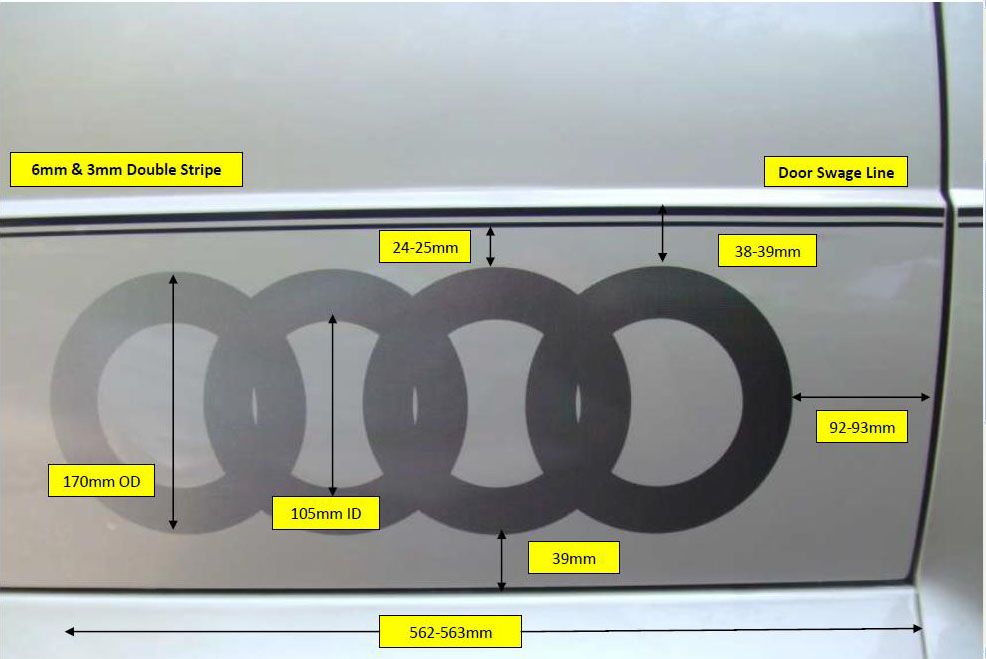

I did a search on this site and via google but I cannot find the answer. I have an 1983 urq and I bought new door ring decals and the audi quattro decals for the bootlids, but I have no idea of where exactly to place them on the panels, could someone give me the measurements?

isimmo kindly gave me the measurements for the positioning of the door decals which i wrote down at the time. i'll get them for you asap (written on a bit of cardboard now in the boot of my quattro!)

I have this saved on my pc, courtesy of someone else's work
Stu is offline   Reply With Quote
