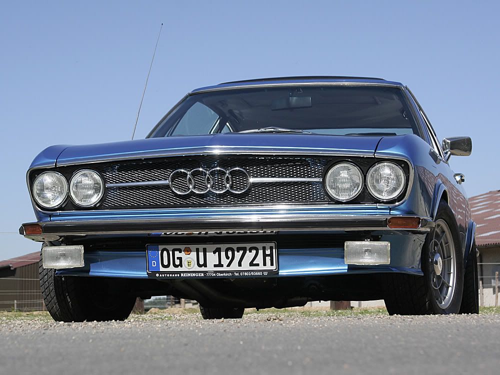

These are similar, maybe wider? Not sure of the origin.
Can anyone confidently ID these wheels and give specs?
What year is this blue 100s Coupe?
It should be either 4x140mm 1970-74 and 4x108 for 1975-76?

Thats the one! looks like shes been around?

Remotec I think Zermatt. No idea of spec but I believe they are still operating in Germany and a long shot - maybe have the specs still?

Seems pretty likely based on other photos.

I can tell from the original version of this picture that the wheels are 6Jx14, but I don't know the offset. The centres of the wheels have been machined out to fit the Coupe's hub and centre caps have been made to fit the enlarged hole.
Incidentally, it's a pre-1974 Coupe (1972 if the numberplate is anything to go by) with 140mm PCD.

they look like 4x140 pcd on that one.
Wow, a huge effort. Stunning results.
Do you have a higher res of this pic?

Yes, I have a higher resolution pic, but the file's too large to upload to 'My Album' on my Profile. I can email it to you if you pm me your email address.
