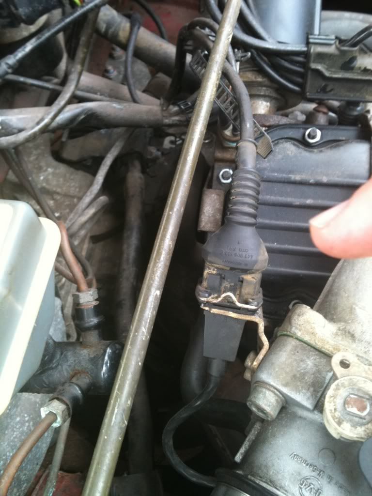

is this the throttle position sensor?
If this is the sensor, it doesn't seem dirty??

nope! That's just a bullet connector connecting two wires - moove the camera to the right slightly and take a not so close picture of the throttle body iteself..
