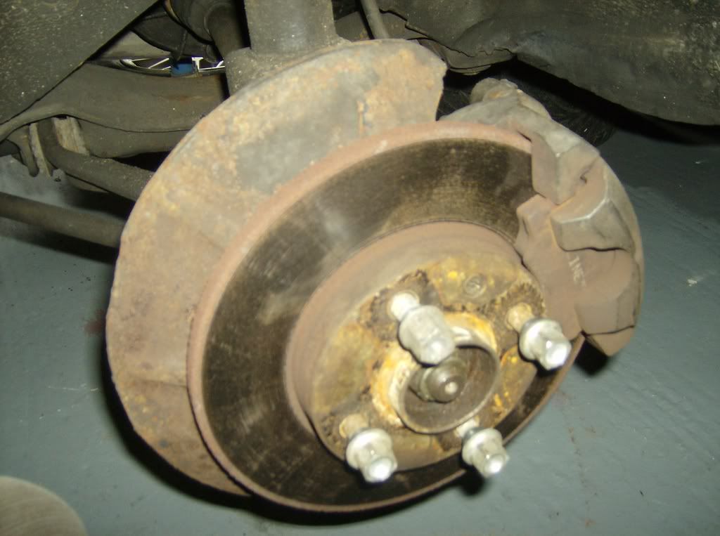

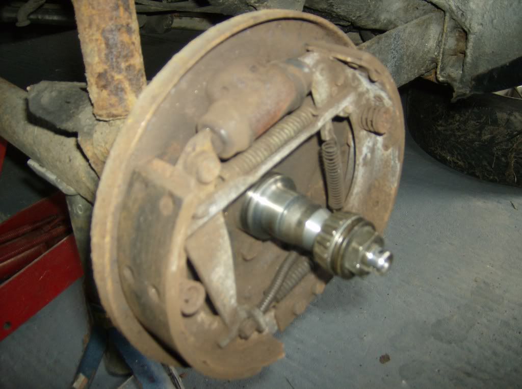

Although I'm no expert I think by backplate they mean the plates on the drum assemblies like this and that would be a failure
whereas the splash shield is this at the back of the disc like this which I doubt would be a failure

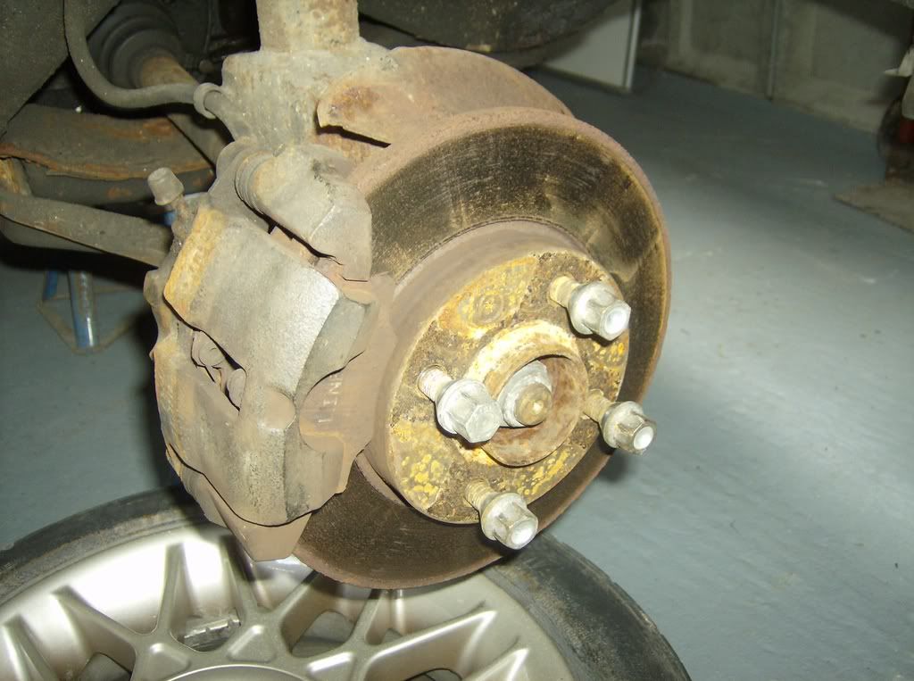

discs all round on the GT, i'll take some piccys and you can let me know what u think of there condition (visually at least).
