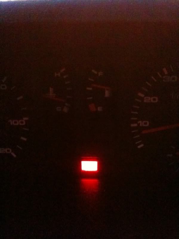

Mine (DZ) but same engine minus 1 cylinder runs here:
It used to run just below half, but I want to change the thermostat, as I think it is running too cold.
