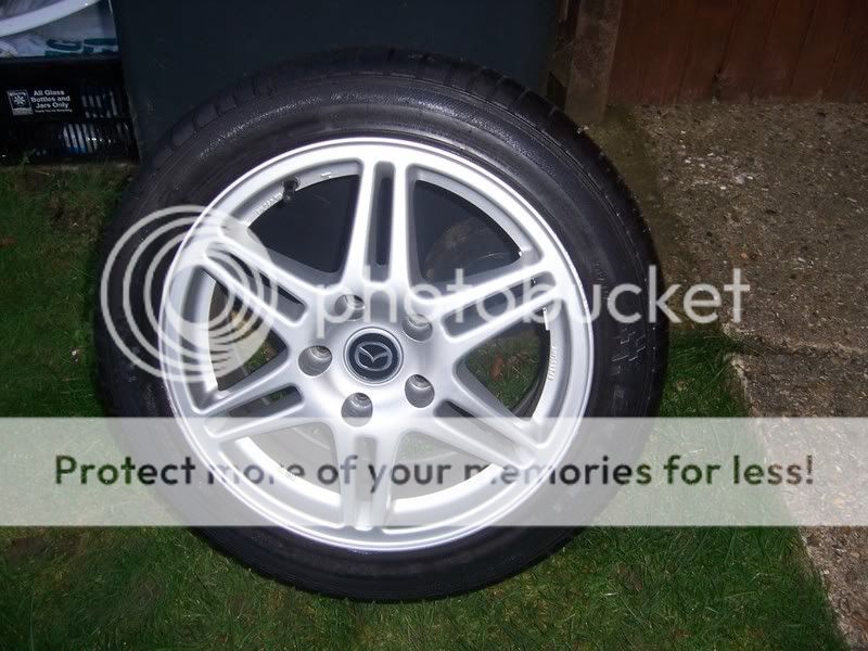

On my previous car when i re painted my alloys i used vw diamond silver and they come up really nice but i will wait for dave's pant code info.

I agree with Martc that the earlier Audi's with Ronals were Zermatt silver, while the 10 spokes on the later cars were a brighter silver - I'd go with the VW Diamond Silver or something similar for the 10 spokes Dave, you certainly made the Mazda wheels look good.
