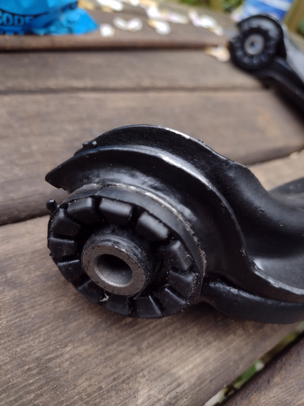

Sorry, I have another question! I've replaced the wishbone to subframe bushes like-for-like with what was on the car... Pic of these below:
[IMG][/IMG]

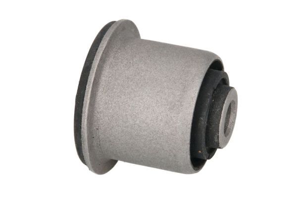

I've just been looking at the Audi parts catalogue on OEM EPC online and noticed those bushes (part number 811407181) are for 81/82 model years and seem to go with the non-sided wishbones. My car is 84 and has the sided wishbones and drop links, which according to the catalogue seem to go with different bushes with a metal casing on the outside for years 83-87, part number 857407181 (see pic below):
[IMG][/IMG]
Anyone know if the bushes are interchangeable? I'm confused now, I thought getting the ones that were on the car was the right way to go, but the catalogue seems to say otherwise. I supposed a previous owner could have had the wrong bushes fitted?!
Any help appreciated! Many thanks.
Old 21-07-21, 10:01 AM   #10
mikes2
Location: Polmont
Posts: 2,617
No problems with the questions.
If you've gone to the trouble of fitting them, I'd be inclined to use them although they may not last as long.
Those bushes are slightly softer - they're used on the early 5 cylinder models which also had a different anti roll bar setup
The metal caged bush can also be 8A0 407 181 - they have a slightly larger flange on them.
