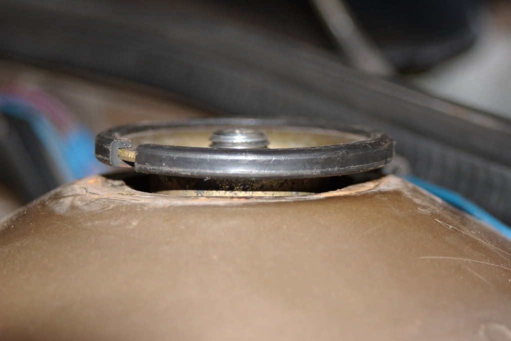

This is how both sides look. As soon as she's on wheels the mountings lift out

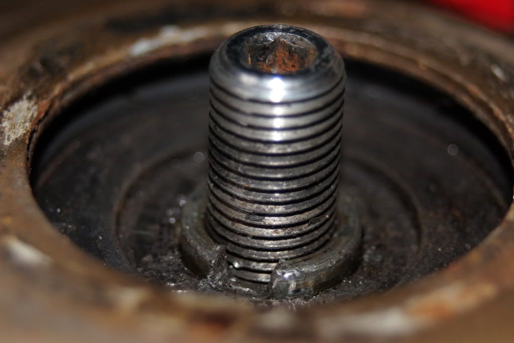

Removing the nut and cap shows the peg nut is sitting proud. It wasn't like this when I assembed the arms so I'm not sure why they both sit up.

How new are the top mount rubbers martyn? I had this on my CQ. The nut looks like its fully down, and any sag in the top mount rubber will allow the top cat to sit proud of the sturt top.

Do you mean the concave caps,stick up proud 2mm????
If so,they should.
All 4 q90,s i,ve owned,the caps stand proud.
Is that what you mean?Mine are higher.
Old 01-05-10, 07:44 PM   #8
Just like that Karl. Are you sure thats normal cos I don't remember mine sitting proud like that when I took them off
Old 01-05-10, 08:09 PM   #9
I,m sure all mine,are(were)like that?Next time I,m at the unit I,ll look at my blue ones.
Maybe they weren,t tightened enough,before you took them off?
