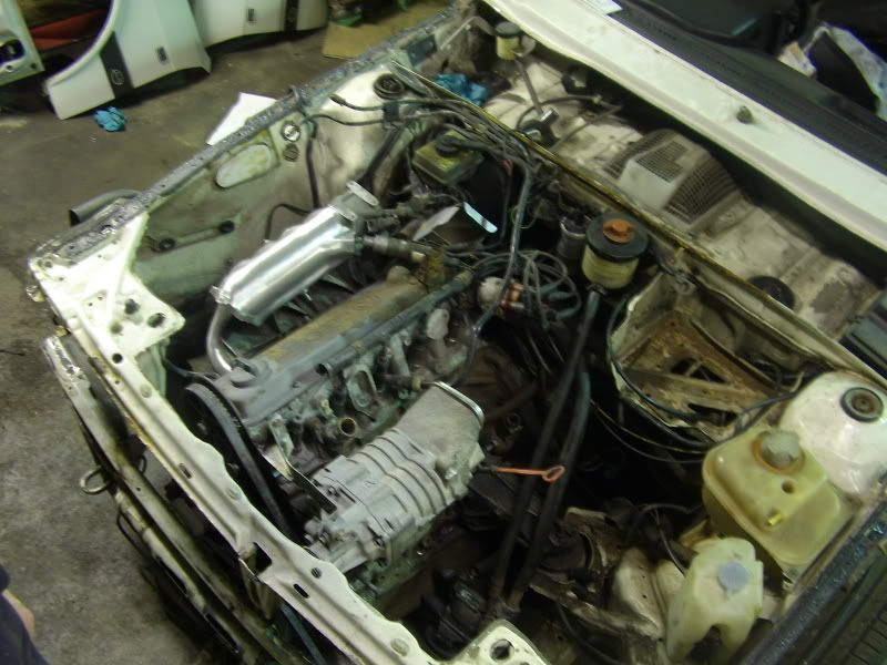

like this poop??

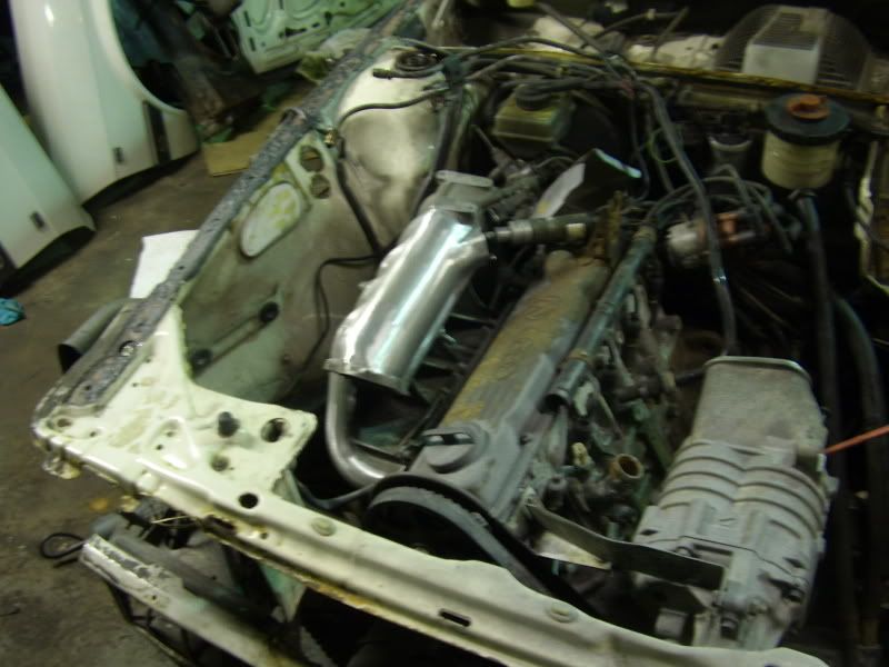

I'm going to be running stand alone on mine, even tho you are right K-Jet can take care of it. Going for stand alone so can map it how i want. Plus for the over boost, i'll be using an after market dump valve set-up. Brakes are something i have not thought about yet as don't know what set up i will be using and smoothing the engine bay at the same time.
When i get home ( which is next week ) i will try get some more pictures for you and let you know how it goes.

Brilliant! I'll look forward to the pics!
