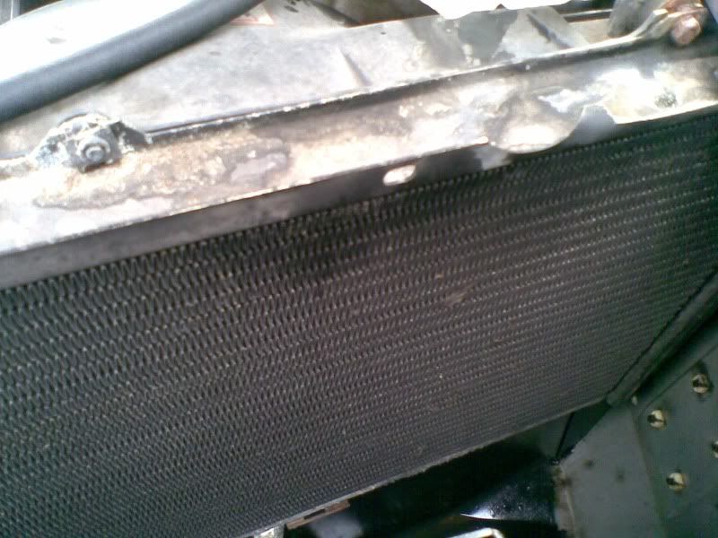

My rad is leaking when it gets really hot, I have found the leak, it is near the top.
I have a spare radiator, any tips for changing it??? I have done a Mk2 GOlf one before. It looks fairly simple, but how hard is it to bleed???

Go to Halfrauds and get some Bar-leaks putty (or whatever it's called) and whack that in the hole... Strong as an ox if you follow the instructions...
Alternatively, change the rad...
Should be a simple swap, change the bushes too, then bleed as normal. Run engine with heater on (that'll be nice, this weather!) and top up as necessary.
G12 is the stuff...

seriously, if you know where the hole is and it can be filled with a putty, go for it, it'll see you good until you've got the time for a rad change...
Old 02-07-09, 09:06 PM   #5
the hole is where the fins are, do I just ram the putty into the fins???

I can't remember the stuff I used (without going down the garage), but I inadvertently stuffed a Stanley knife blade into a rad whilst bearing wire, it pee'd fluid even when the pump wasn't running. Whacked some similar stuff over it and packed out the fins to an area about the size of an old 50p piece...
Promised I'd change the rad as soon as possible... Car was destroyed by local youth 8 months later and over 3000 miles, without loosing a mm from the header bottle max line...

Just work it into the fins deep the first time, because if it sets and the leak isn't cured, you've got to pack it from the reverse side... So don't be shy of it... Better to loose a small area of fins and fix the leak than go all soft and smear a bit over the fins, and not fix the leak.
