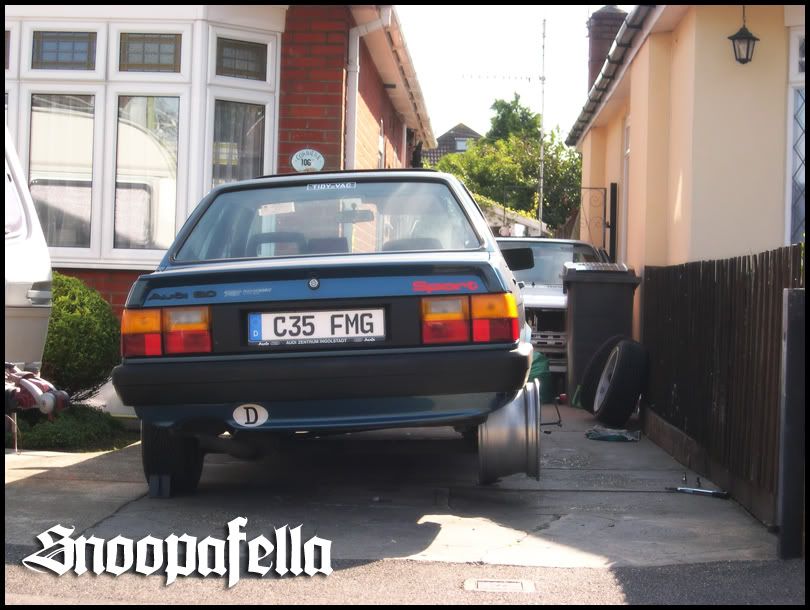

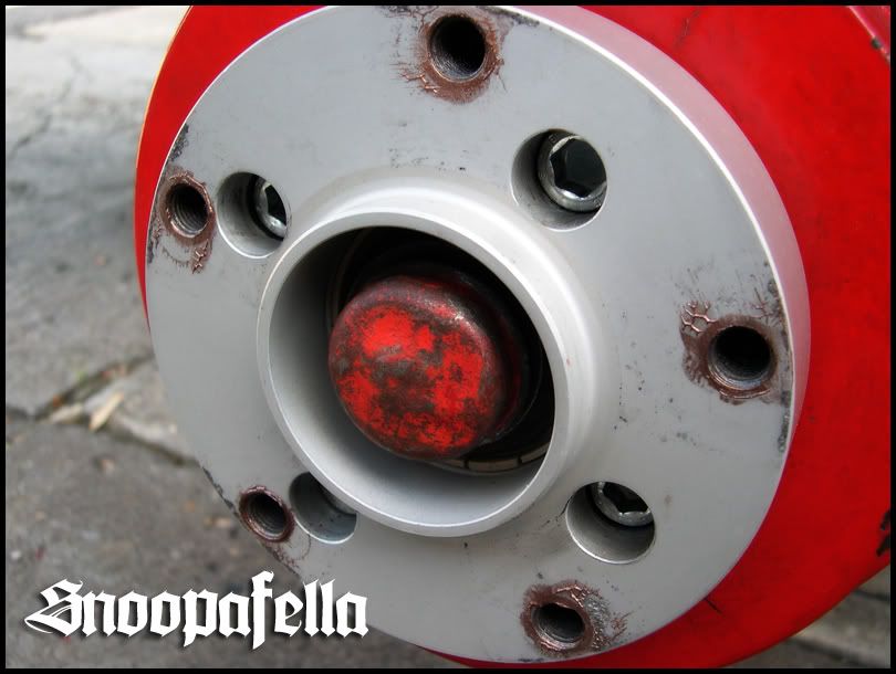

I have a set of H&R adapters, 4x100 to 5x130.
A 25mm thick pair on the front and a 40mm pair on the rear. Same as 90Quattro never had a problem, just watch your bearings as they tend to wear a bit quicker, had to have both my stub axles replaced!
Minimum width you can get is 15mm, and some combinations, as the mentioned change from 4x100 to 5x112, will require a 2-piece adapter because otherwise the bolt holes will overlap in an unusable manner, sort of ending up with 2 half holes type thing.
Also as discussed the spacer/ adapter will alter the wheels ET but not as mentioned. Basically you subtract the width of spacer/ adapter from the ET. So my ET 60 wheels become 20 with my 40mm adapters -
PS steer clear of steel adapters as these weigh a ton and don't clear as well -
(I borrowed these from a friend to trial fit a set of wheels)
