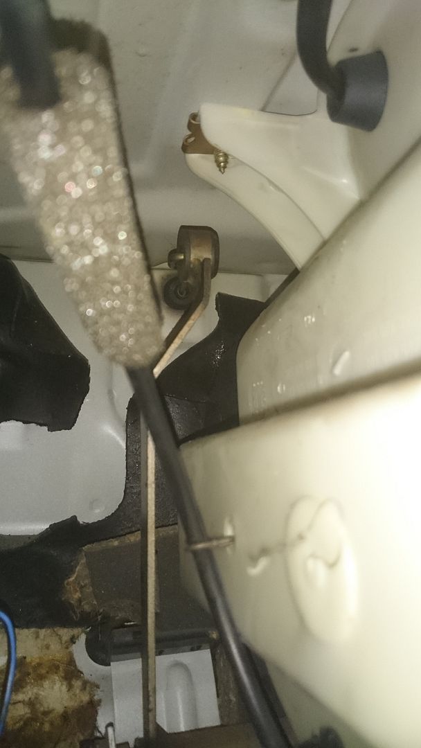

Im after the bush that captures the accelerator cable under the passenger side of the dash where it joins the lever mechanism. Any info/ ETCA diagrams etc appreciated. VBR Ian.

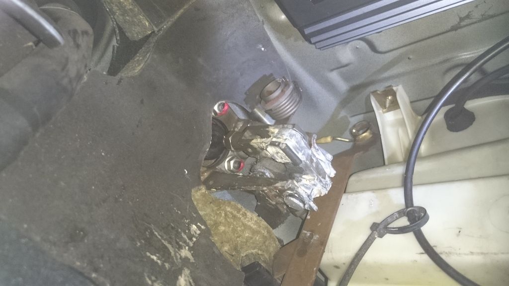

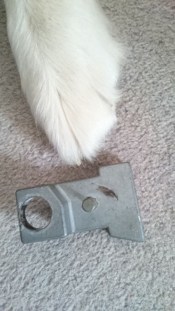

I have had a chance for a closer inspection today and 'found' this, which I assume is item 5 resting behind the carpet...
As a temporary fix to get the car home I had just attached the cable straight to the lever and adjusted the cable accordingly, not realising there was a chunk of metal called 'item 5' missing.
The question is, what does item 5 actually do?

The metal piece is just a weight probably to aid the return of the pedal to its home position. You need two of those bushes did mine today!!!
