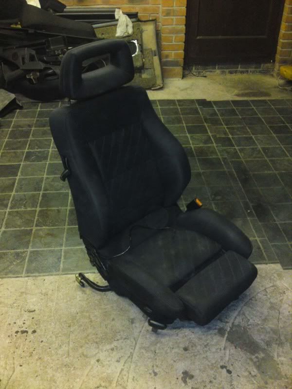

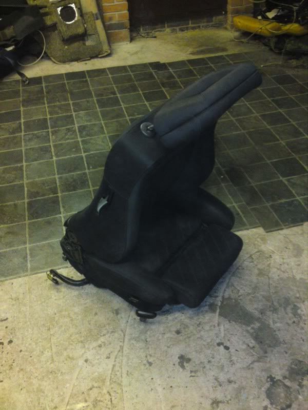

You can use C4 platform S4/S6 seats which fit straight onto the B3/B4 platform height adjustable subframes. They are much more supportive than the cab seats, bigger bolsters & adjustable thigh squab. Only issue with those is that they don't tilt as standard.
I modified a set to tilt a few years ago to go in my coupe - you need to harvest the parts from a set of coupe/cab seats and strip the backrest down to the bare frame a cut & weld a couple of bits - pretty easy but time consuming and not for the feint hearted.

To be fair they look nice!
