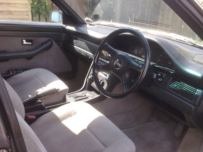

i just brought a audi 100 1988 2226cc and the problems so far are the spedo works but the mileage dont is it electronic? and ther is no oil light on dash, changed the bulb no joy
any ideas please

no its my 100 sport i just brought but it has a wire going into it as well as a cable drive

Is yours the "facelift" curved top dash???
Like this:
If the speedo needle is "jumping" slightly, the milometer doesn't register.
Steve
Old 26-09-08, 10:01 PM   #5
no its the square one
