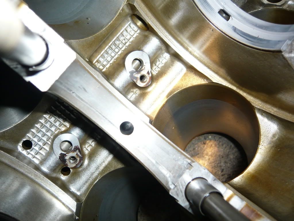

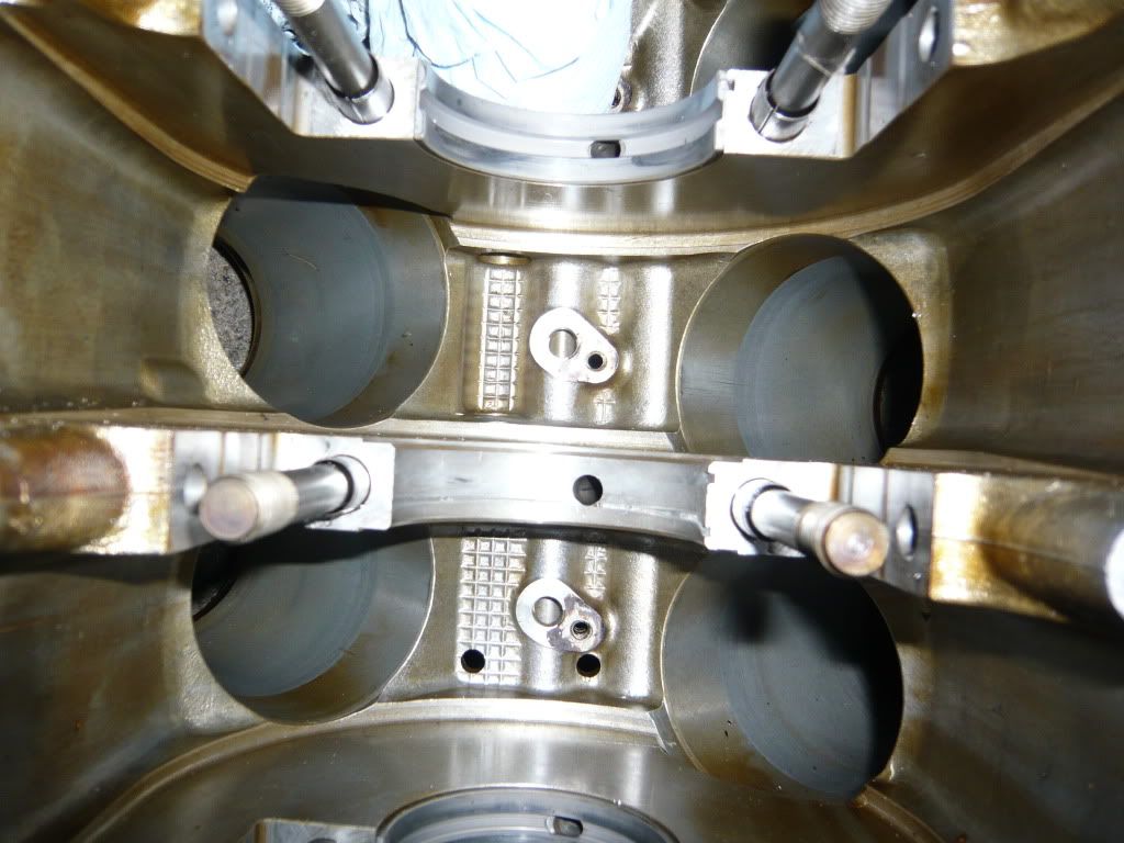

Dead engine block. Ally block, mai bearing suds still in, but otherwise stripped, and sadly, scrap, due 2 cracks, one serious.

The smaller crack is in the head face of the right Bank. (the left bank may still be off limits...)
The second crack is on Main bearing number 3 support. goes right through the oilway, long wise with the axis of the crankshaft. Associated with this is the main bearing shells had turned with the shaft through 90degress, and chattered across the seating face.
Difficult to see from these pics. I'll take better ones tomorrow.
To resolve it, it would need a weld, line bore. crank grind. head mating faces skimmed
It could be done, but financially makes little sense.
