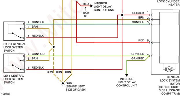

This should be the wiring diagram for the door switches. Red is ign switched +12v and Red/Blk is perm +12v:
I would start at the pump to check the continuity of the switches. Google can explain how to check car wiring with a multimeter better than I would

The whole lot is just dead, no pump noise just nothing at all mate.
Is it working on the boot lock?
Nice diagram
My old S2 had no central locking, turn out it was a soldered joint on the PCB........this was the feed to the actual pump. Worth a wee look as it was an easy fix.
