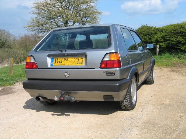

I like the carb, and I loved my Mark 2 Golf Driver with a 2.0 TSR engine I once had.....
