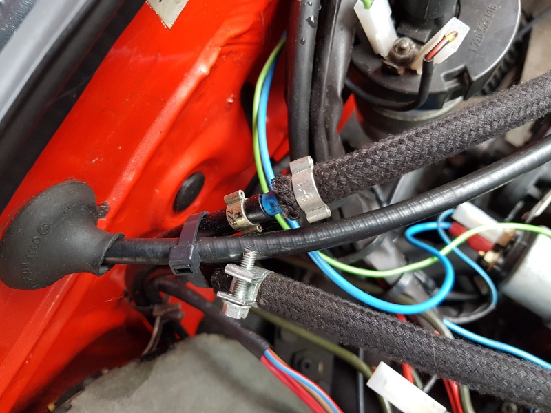

Found a pic...
Top is feed, Bottom is return. Middle is speedo. Petrol pipe to the right is the braided sourced from heritage.
You can just see the blue barbed reducer on hte feed pipe join.
