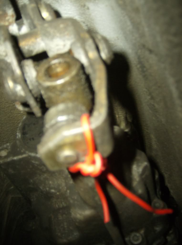

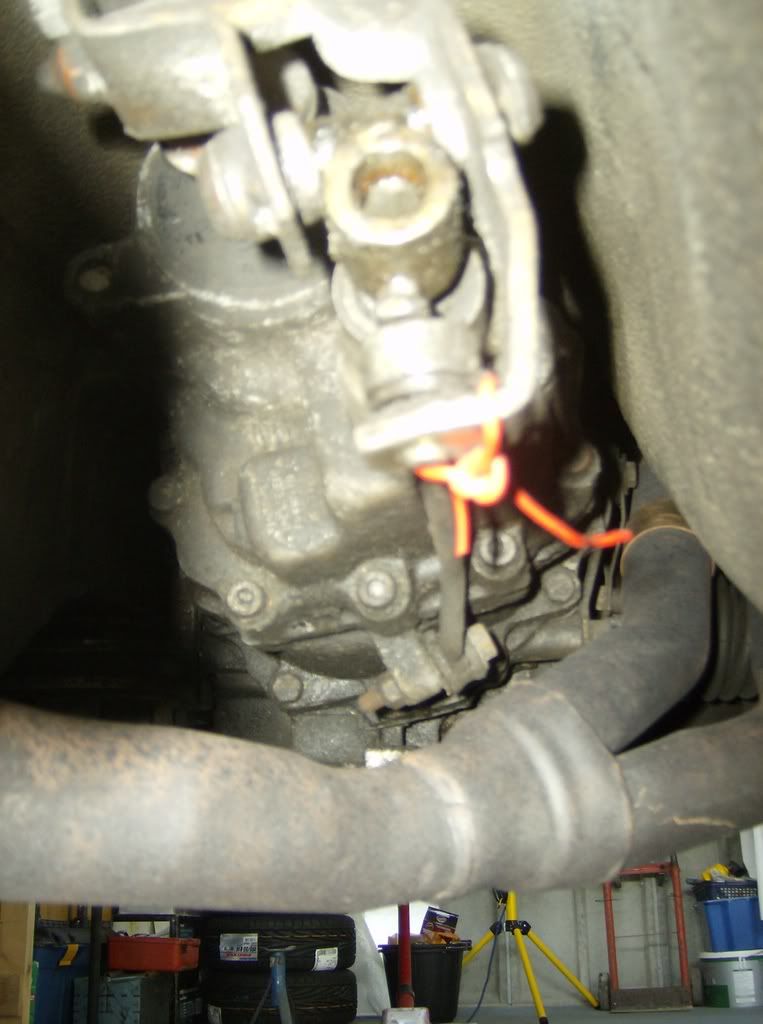

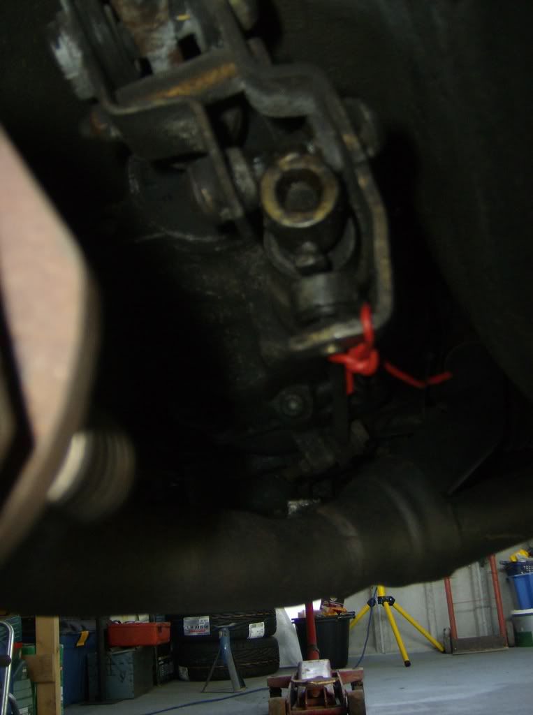

Gear box went again today so I had a good root underneath. There is a bar attached to the gear box housing with a ring at one end. A rubber bush fits in this and the gear lever linkage ends with a ball which sits in said linkage. Bush has perished thus the gaer lever falls out. No wonder it has been feeling like a stick in a bag of marbles at times.
So:
Anyone have a bush or know the part number
or
Anyone have a complete bar with bush included or know the part number.
I'm going to try Audi main dealers on Monday but don't hold out much hope there.
Here's a couple of pics of said item close up. The red cable is my bodge to try and keep the 2 together for the time being.
