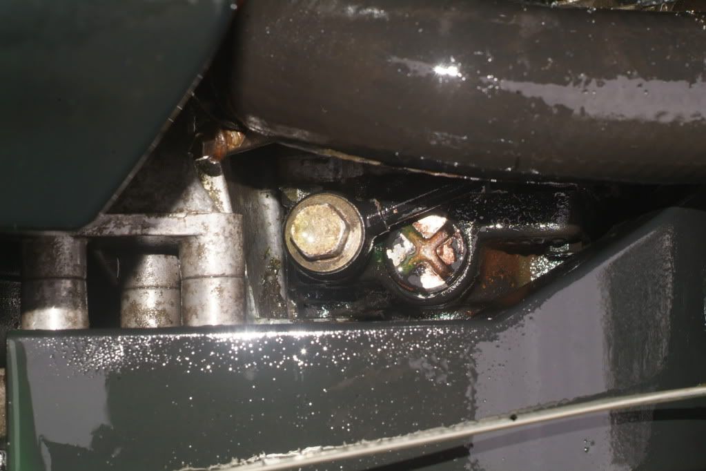

Got fluid spraying out of pump at top,warning lights from computor got my attention,happend while i was out for a joly wee day off drive three power steering bottles of fluid later i'm home.Engine and underside of car has now been undersealed What a mess all the belts are soaked in it.Fluid s coming out of screw with+ on yhe top.Had a look seal was gone,got some new ones and fitted one,Still leaking from that srew,anyone got any ideas as to why after seal was replaced still leaking,is this screw some sort of valve as its fitted on top of a spring.
see pic

Is it noisy?.....The valve seals inside have probably gone, the top one is normally the last one to pop......Re-con £250ish?

looks lke the thats on the S6?
mine did that 2 months ago, got the unit reconed and fitted for £150. All new internals.
You can by the X head bolt and a seal kit form Audi still for £20/30, provided that is where its leaking.

Tried to get seal from vag,parts said it was not listed,could'nt find on computor.Where did you get your recon? I fitted a seal from landrover parts dept,was similar size,no difference just kept spraying out.Speaking to local motor engineer tomorrow,need to get her fixed asap

Just spoke to Audi got a seal kit for £18 pick up thursday.Try that first before stripping down and sending off for reconditioning
