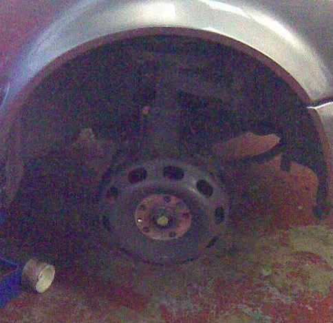

Old 20-06-08, 03:49 PM   #4
I don't know if the urS4 got the same silly brakes as the V8, with those big holey covers OVER the discs, not the metal backing plates......
Old 20-06-08, 03:57 PM   #5
mortcars
mortcars's Avatar
Location: Portsmouth
Posts: 163
i think thats what ive got, they are def over the brakes as its the first thing i see when i look at the alloys!
crappy phone pic

Old 21-06-08, 12:57 AM   #8
AlanB
AlanB's Avatar
Join Date: May 2008
Location: Lanarkshire, Scotland
Posts: 103
Hi Mort,
Sorry!... you were on about summat different entirely!
Those ARE your discs!....... they are "inside-out"..... mounted from the edge, with the caliper facing "out"..... fitted over the inside of the disc.
Get underneath and have a good look from the centre of the car; You will figure it out.
As P-D suggests, the best option is a set of conventional discs and calipers. Yours are very prone to warping; the very thing they were (allegedly!) designed to prevent.
AlanB
AlanB is offline   Reply With Quote
Old 21-06-08, 07:36 AM   #9
mortcars
mortcars's Avatar
Posts: 163
ahh ohh shit! i was afarid they were them wierd discs. well so ill have to get summit sorted soon as mine are warped to buggery. PD any news on that artical? looks like im gonna need to do that asap
