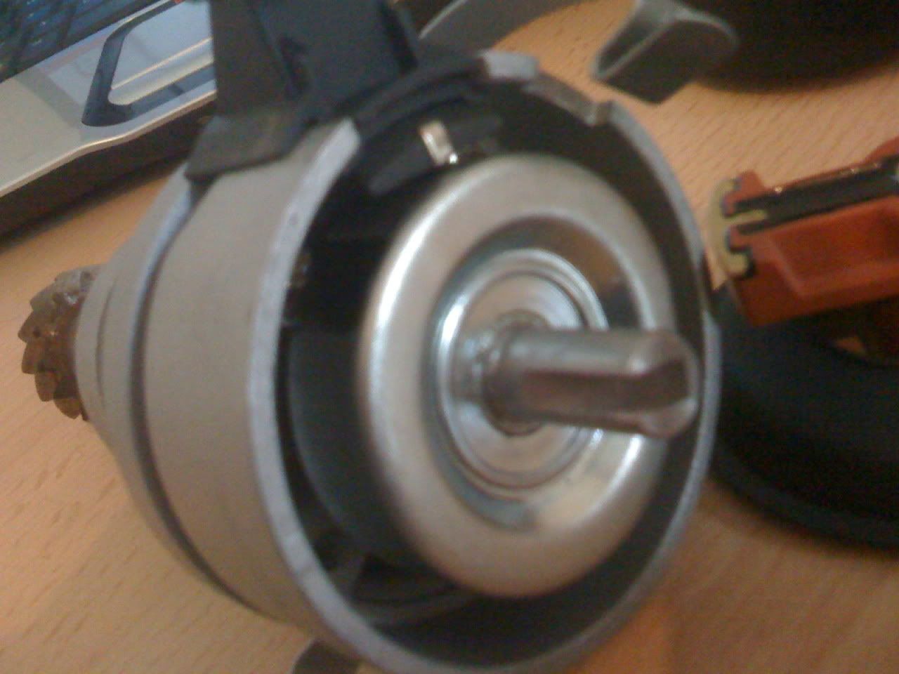

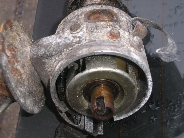

firstly: doh!
http://img.photobucket.com/albums/v255/coxy914/007.jpg
http://img.photobucket.com/albums/v255/coxy914/005.jpg
http://img.photobucket.com/albums/v255/coxy914/006.jpg
steveb 13-05-09 12:33 PM
from a 5 cylinder 10valve
http://i64.photobucket.com/albums/h1...s/P5130175.jpg
you should have 5 of those lugs / gaps yours looks like it has only 4

Coxy 13-05-09 12:44 PM
err, mine has only 1 gap

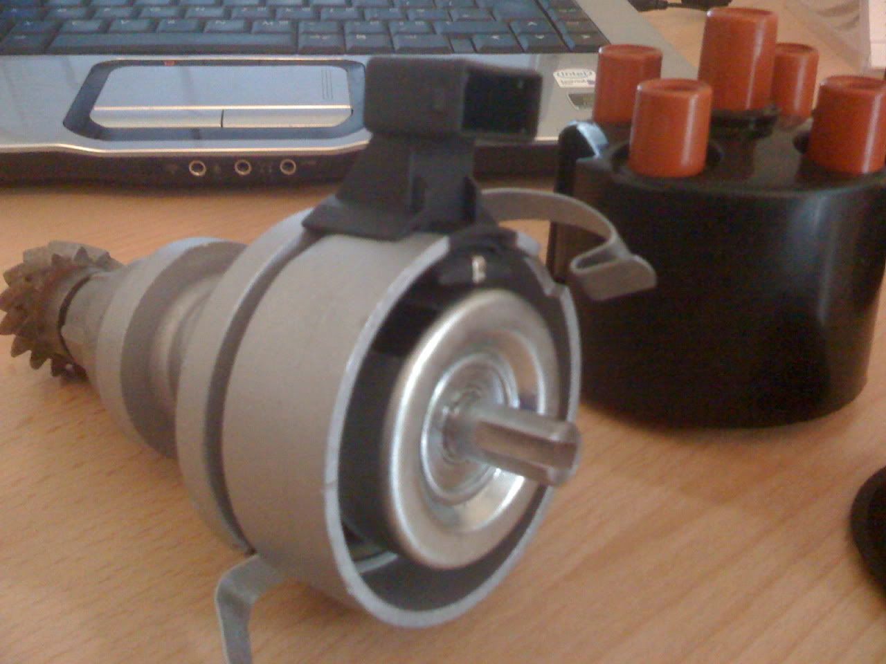

spink 13-05-09 12:47 PM
3 Attachment(s)
7a dizzys only have one window
Coxy 13-05-09 12:51 PM
oooh! that looks like a matching pair!
msh 13-05-09 02:32 PM
All R4's of old audis have distributor with four windows because R4 engines is without additional crankshaft position senders like R5.
20vcqdriver 13-05-09 07:50 PM
Looking at that pic of new one and comparing to the stripped one in my article it looks like you can use it with your 5 cylinder cap. Try it and see!

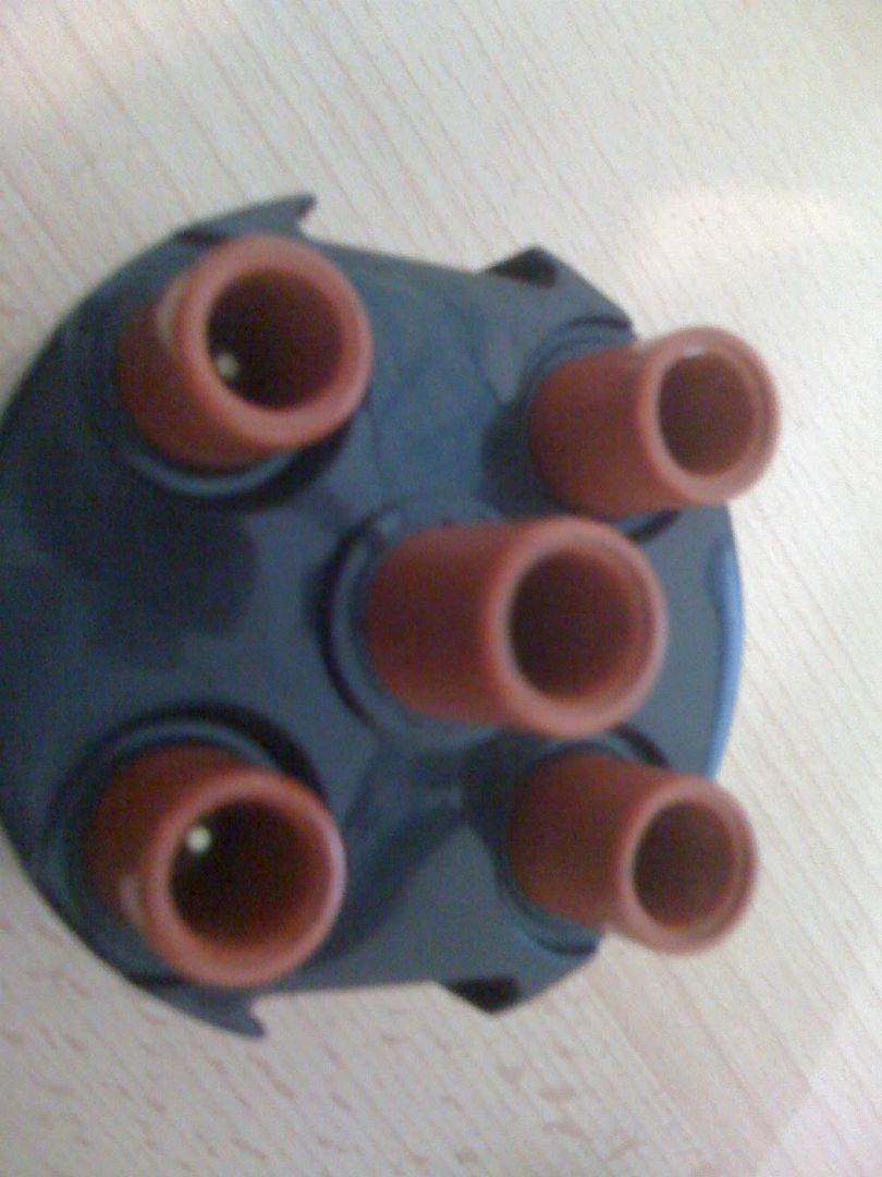

Coxy 13-05-09 08:00 PM
yup, got it home and compared it to the one on Alex's coupe and they are the same.
Should never doubt a man who sells a complete dizzy for a 5 cylinder motor and puts on a 4 cylinder dizzy cap!
